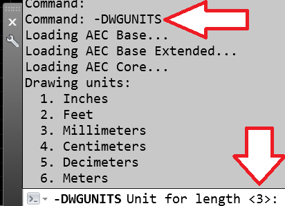

JD Mather Posted November 19, 2012 Share Posted November 19, 2012 Thankyou for the suggestions but unfortunately none of them worked. UNITS and DIMSTYLE do not show which template was used. I don't see anywhere in this thread where anyone suggested UNITS. -dwgunits IS NOT UNITS Also a look at dimstyle can indicate whether imperial or metric template was used. (but you have to know what to look for) If a custom template was used..... Post screen shot of what you see when you enter -dwgunits (might expand the command line a few lines). Quote Link to comment Share on other sites More sharing options...

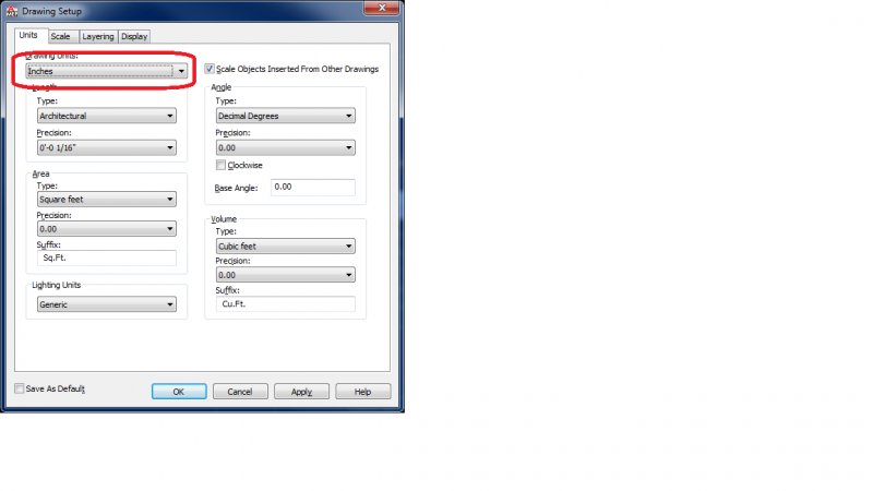

RobDraw Posted November 19, 2012 Share Posted November 19, 2012 (edited) If -DWGUNITS can be set from UNITS. What is the difference, teach? Edited November 19, 2012 by RobDraw Quote Link to comment Share on other sites More sharing options...
JD Mather Posted November 19, 2012 Share Posted November 19, 2012 If -DWGUNITS can be set from UNITSs. What is the difference, teach? When I type in UNITSs I get Uknown command. I don't know how to get access to the same settings available in -dwgunits in units. Can you post screen shots teaching me how? Quote Link to comment Share on other sites More sharing options...
RobDraw Posted November 19, 2012 Share Posted November 19, 2012 Change this and then check to see what happens in DWGUNITS. Quote Link to comment Share on other sites More sharing options...

JD Mather Posted November 19, 2012 Share Posted November 19, 2012 Change this and then check to see what happens in DWGUNITS. [ATTACH=CONFIG]38678[/ATTACH] Ahh, you are using a dialog box where I am using command line commands. Been so long since I used AutoCAD I don't even know how to get that dialog box shown in your posted image. Quote Link to comment Share on other sites More sharing options...
RobDraw Posted November 19, 2012 Share Posted November 19, 2012 There is only one "s" in units. I corrected the spelling in my post. Quote Link to comment Share on other sites More sharing options...
