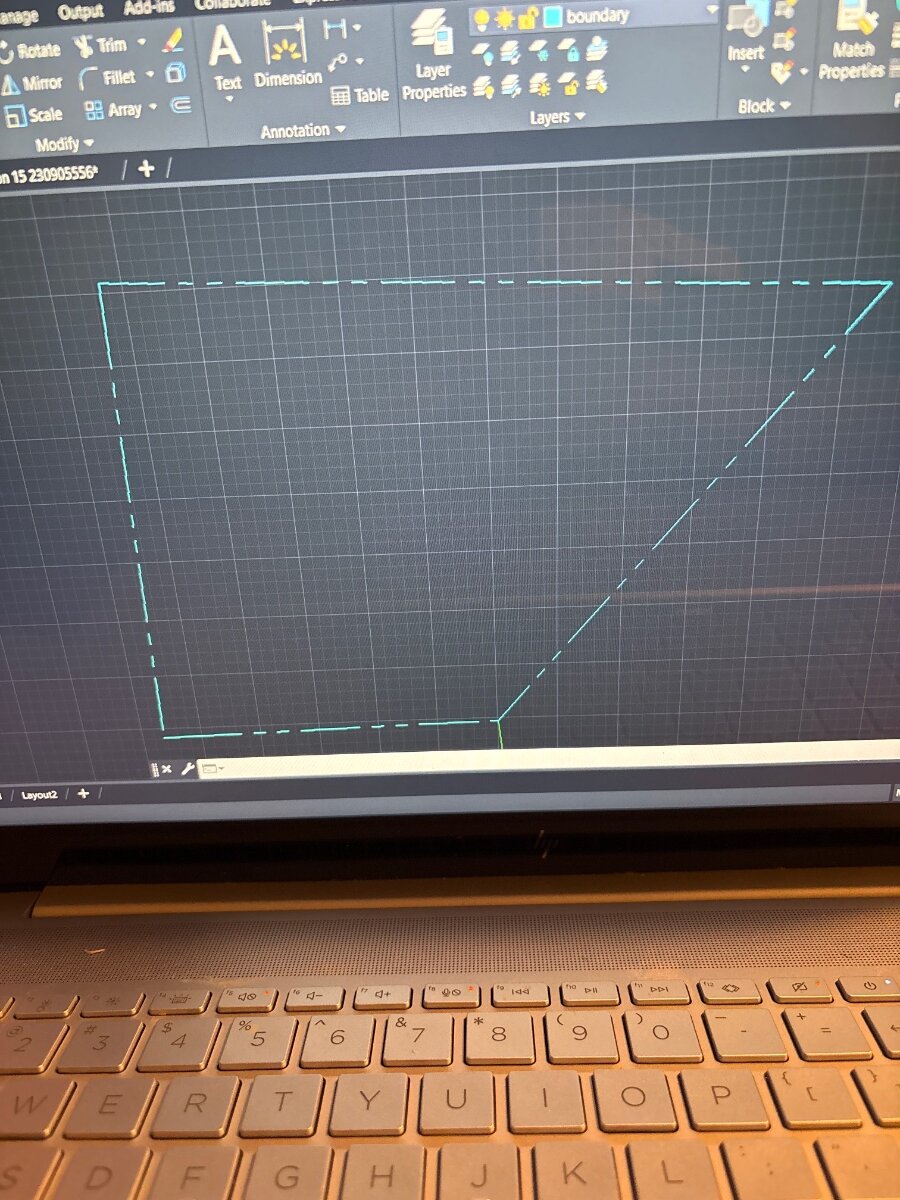

Kayy Posted February 28, 2025 Posted February 28, 2025 Hi @ReMark I got lol I didn’t expect for the line to be so small. I followed your instructions and I’m stuck on where to start Quote
ReMark Posted February 28, 2025 Posted February 28, 2025 Once you have created the line from the benchmark to the lower left-hand corner of the subdivision it is time to create the subdivision boundary lines using the information provided in your instructions. The boundary lines are created in a counterclockwise direction, starting at the end of the previously constructed line, in the following order: east, north, west and finally the south. Quote

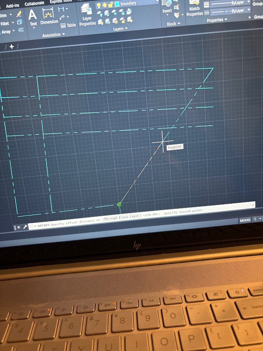

ReMark Posted March 1, 2025 Posted March 1, 2025 You start the OFFSET command, input the offset distance then choose the line you wish to offset by specifying which side to offset it to. I will be unavailable after this post. I am going out for the evening. If you have further questions I will attempt to answer them in the morning. BTW... where are you located? Quote

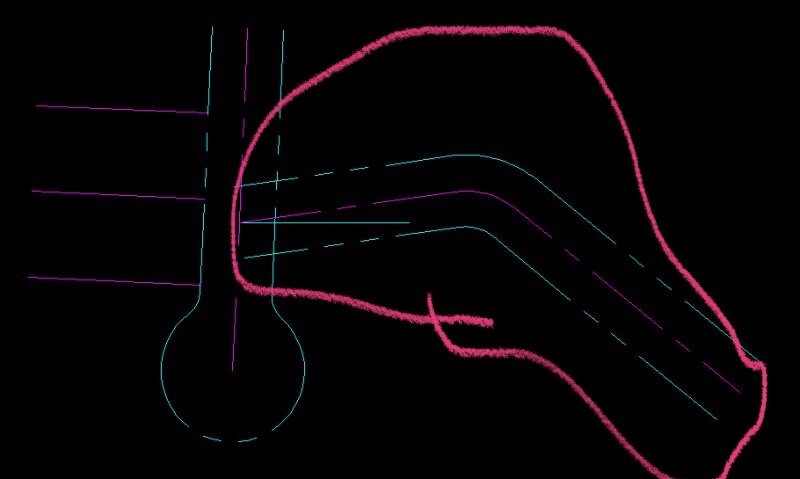

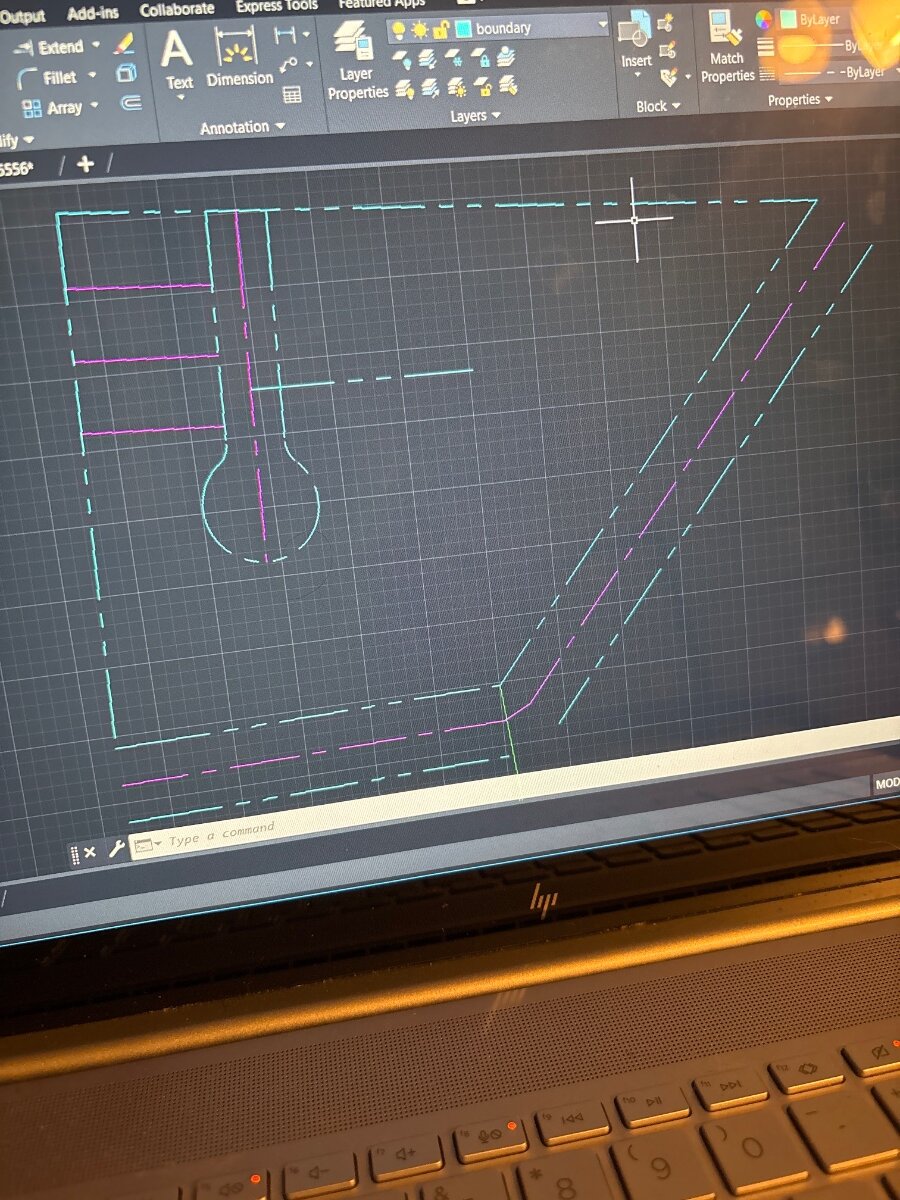

Kayy Posted March 1, 2025 Posted March 1, 2025 Ok no worries, VA and I’m trying to figure where and the length of the road I drew the center line but I’m stuck. Quote
ReMark Posted March 1, 2025 Posted March 1, 2025 (edited) In the image above the centerline for the road with the cul-de-sac should end at the center of the circle. And the two centerlines at the bottom and right should come to a point not an angle. BTW... I am in South Carolina. Edited March 1, 2025 by ReMark Quote
Kayy Posted March 1, 2025 Posted March 1, 2025 The road you made is that a measurement we have to figure out on our own? Quote
Kayy Posted March 1, 2025 Posted March 1, 2025 This road that you drew is it measurements we have to figure out? Quote
ReMark Posted March 2, 2025 Posted March 2, 2025 No. The student is given the bearing and distance of the two lines that make up the centerline. Quote
