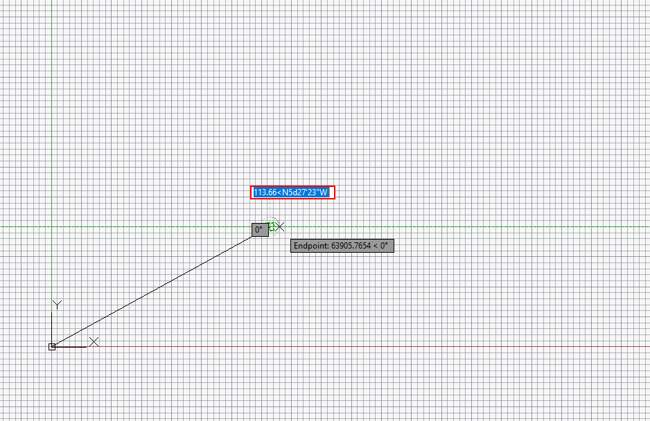

For the next point type, at the command line, @113.66<N5d27'23"W (see image in next post).

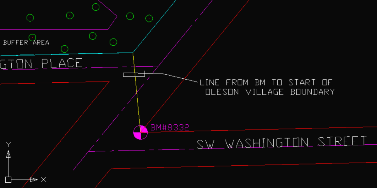

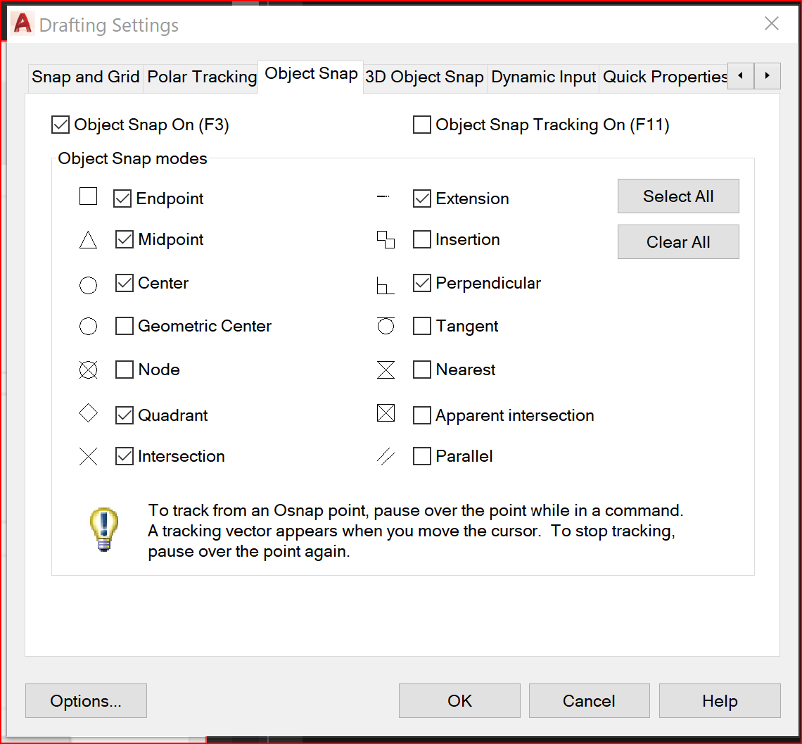

I have disabled orthomode and started the Line command. I hovered over the end point of the reference line and then let go of the mouse, When i enter For the next point type, at the command line, @113.66<N5d27'23"W it gives me an error. I am typing the cordinates exactly as is. What am I doing wrong?
And what error are you seeing exactly?  BTW... after entering the distance and bearing did you press the Enter key?  The line you are being asked to draw should end up pointing northwest.  See image below.
Edited by ReMark

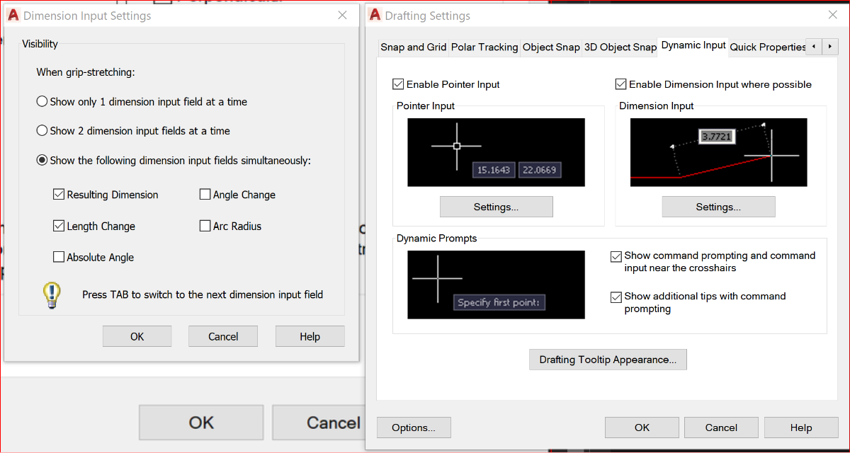

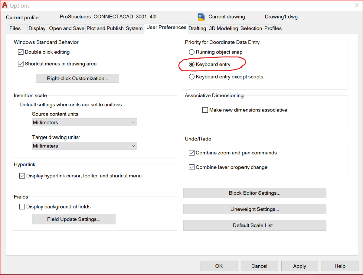

It sounds to me like you need to go into your OPTIONS, and on the
USER PREFERENCES Tab select   KEYBOARD ENTRY, it looks like
your preference is set to Running OSnap.  Or perhaps disable any OSNAPS which
don't serve you during this process, in your OSNAP SETTINGS.   :beard:
If it still isn't working as you prefer, take a dive down the rabbit hole into More Drafting Settings, as per the following screenshot... :thumbsup:

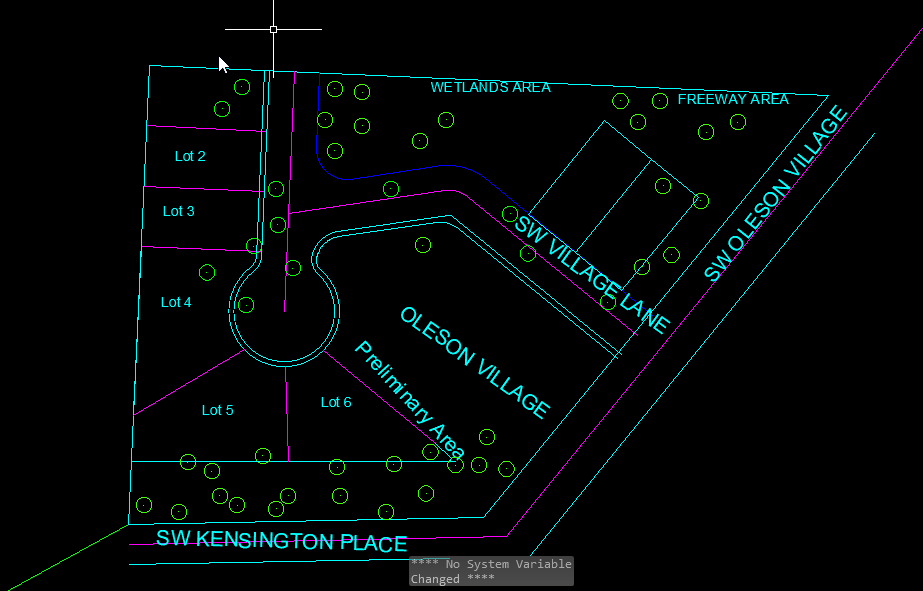

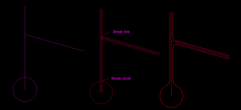

Hi Remark, thank you for all the advice. i am stuck at creating the buffer, sidewall, parking strip and curb. Can you please help me walk through this step by step. Here is my current drawing so far. Disregard text style and font as I do know it is incorrect. I just added them for now for reference. image.thumb.png.f9fe3d79e2ba923ab21f49d35bc2d2ef.png
Edited by rollie27

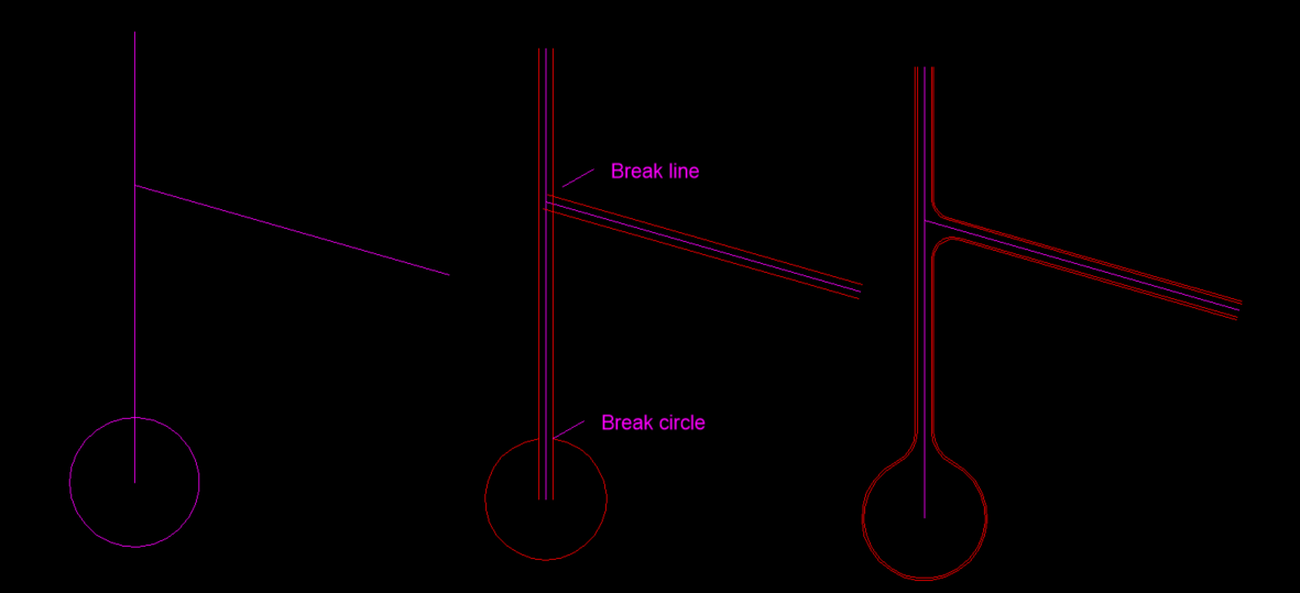

You have the purple centre line of the roads so offset left and right for curb, we call it kerb. Draw a circle for the court bowl again offset left and right. The curb returns are done by using the fillet command.
rollie27: If you already have the streetlines drawn, then all it takes to draw the buffer, sidewalk, and parking strip is using the OFFSET command.  The trick is to offset in the correct direction and at the proper distance.  Typically, streetlines also serve as property lines so the buffer, sidewalk and parking strip need to be drawn between the streetlines rather than outside the streetlines.

I am trying to draw a property line for Lot 5 and the project guide states: the property line heads in a northerly direction at a bearing of N1°15′7″W. However when I draw the line from the intersection of the Lot 5 circle and the southern property line and use the LIST command I am getting a different bearing of N1d15'19''W instead of the N1d15'7''W did I mess up the drawing at some point or is the guide incorrect?
You are referring to the lot line shared by both lot 5 & lot 6 are you not?  I just checked my master drawing for the Oleson Village project and it matches exactly what you are getting.  Good work.  Keep going.
