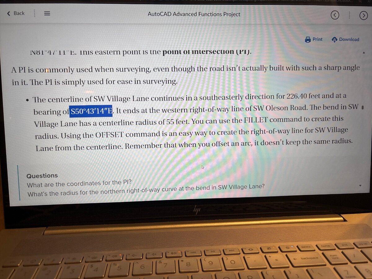

Penn Foster Student Suffering with Oleson Village Map!!!
I’m sorry to be a pain I found the bearing but when I put it in Autocad it says invalid
Try like this.  @226.4<S50d43'14"E
Note the "d" or "D"
I'm sorry you are having trouble but this is the same method used to put in all the boundary lines so it is possible you just mis-typed something.  Even something as minor as a missing < ' > symbol will cause an error message to pop up.  Follow BIGAL's advice and you should be fine.
Edited by ReMark
Hey @ReMark can you help me on the lot 7 and 8 I’m not sure if I’m putting the Measurements in right?
Lots 7 & 8 are the same size... 60 x120.  The 120 ft dimension is perpendicular to the north street line of SW Village Lane while the 60 ft dimension is parallel to the north street line of SW Village Lane.  To create the easterly property line of lot 7 offset the westerly street line of SW Oleson Road a distance of 50 ft.  Offset that line 60 ft to the west.  Then offset that line another 60 ft. to the west.  Offset the northerly street line of SW Village Lane 120 ft. and trim everything up as required.

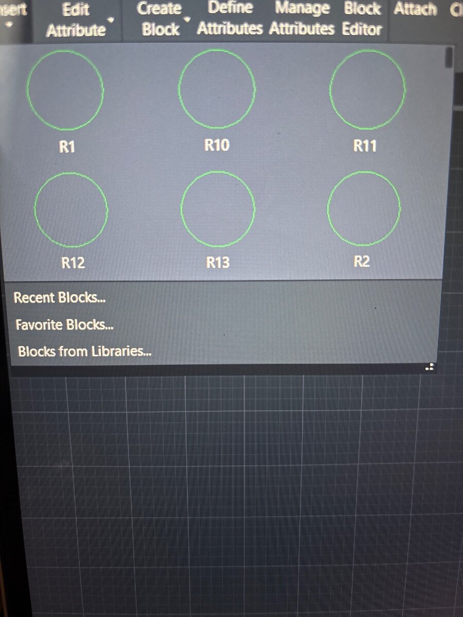

Good afternoon @ReMark I’m not quite understanding this part of the project?
The student is instructed to insert a tree block (previously created) at various locations through the subdivision based upon a list of coordinates given in the instructions.  The text above suggests that instead of typing in the coordinates for each location, and possibly mistyping one or more, the student copy and paste the coordinates.  Have you created your tree block?
Edited by ReMark
I tried to copy and paste the locations on the trees but it keeps pasting on the drawing.
Did you create a tree block (only one is required)?  Did you copy the coordinates from the instruction booklet and paste them into AutoCAD (using the Block, then Insert command) when prompted to "specify insertion point"?  Note: one pair of coordinates per insertion.
Edited by ReMark
Yes and ok I will try that then and I’m sorry for late response I work at night so I sleep through the morning I get off at 7am.
I don’t know why but the tree block and inserting the tree is not working for me. @ReMark I don’t know what I’m doing wrong
I have sent you a message that includes my email address.  Do a "Save As" of your P-F Oleson Village Project drawing and save it as an AutoCAD 2010 or 2013 dwg file then send it to me.  I will take a look at it and determine what the problem is.
Edited by ReMark

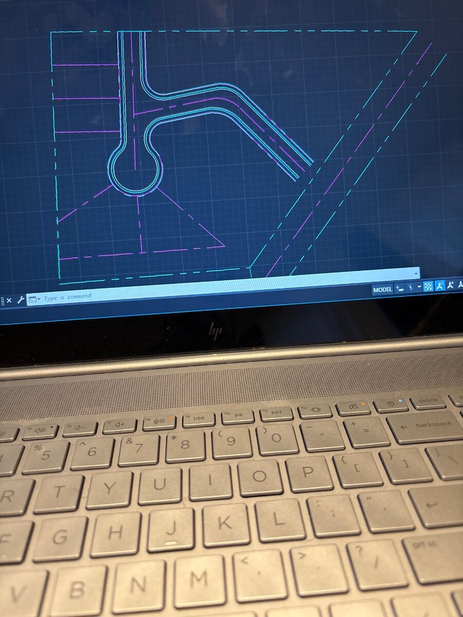

Hello, I'm at the final steps for this project and I'm stuck on 2 parts. First is the dimensioning the total length of the lot sides added together. It says to use a dashed line for the arc and line, but the list of layers never mentions a layer that uses dashed lines. Is this some sort of annotation setup that I'm overlooking? And is there a command for the having the ends of the dimension being arcs, or do I need to make those manually?
Second part is the setup for the border. I understand it's a 24 x 36 and that 1 unit equals 1 foot and that I will need to scale it up once created. But then they throw in the line that the actual input is 2 x 3 and I'll have to figure out the math. This is throwing me for a loop, or possibly my brain has just turned to mush from overthinking it. Thanks in Advance for the help.
You're right, there is no mention of a layer that makes use of the dashed linetype in this project.  I suggest you create a layer called "Arc", layer color "white" and assign it the "Dashed" linetype.  There are only four overall (boundary) dimensions that will require manually created arcs.  As for the title block and border draw it per the instructions.  When completed use the Scale command to scale it up.  The scale factor should be 50.
