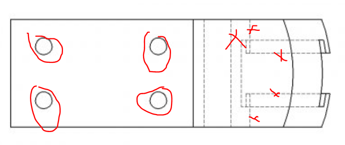

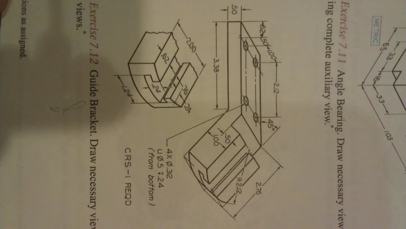

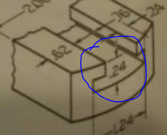

Njprince94 Posted December 12, 2012 Posted December 12, 2012 (edited) I was asked to draw this drawing with a front view, top view and a auxiliary view but I am not quite sure what I was asked to do because there are two seperate parts to this drawing. Can anyone maybe roughly draw up what the views would look like? Even a drawing on paint would help I just need to know how its supposed to look. Thanks I do have some experience in autocad and my latest and drawing was this with 7 views. (18)THEFINALFinal Project - Control Bracket.dwg Edited December 12, 2012 by Njprince94 Quote
Dadgad Posted December 12, 2012 Posted December 12, 2012 It looks like a single part to me, from what you have shown. I would suggest that you get ahead of your class and try to do a 3D Model of it. If you manage to do that you you can daze and amaze your instructor with VIEWBASE generated 2D drawings from a total of 8 typical perspectives, and maybe throw in a vewport with a realistic visualstyle perspective to get your work well over the goal line. It may well be easier to model it, and let the software draw it. Quote
Njprince94 Posted December 12, 2012 Author Posted December 12, 2012 OHHH wow im so oblivious..it is one piece haha :S Thats a little overboard at my level! Would you mind showing me what the auxiliary view would look like for that drawing? Quote

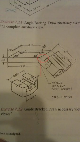

Njprince94 Posted December 12, 2012 Author Posted December 12, 2012 Okay I dont even got how to do the front view. I dont know the distance near the angle of 45 degrees. That empty space. :/ Quote
Dadgad Posted December 12, 2012 Posted December 12, 2012 The distance to the 45 degree segment is shown along the bottom edge of the horizontal member. Draw a line at 45 degrees from that known location, then offset the line by the known thickness of the part. Quote
Njprince94 Posted December 12, 2012 Author Posted December 12, 2012 I meant the top view and this part sorry Quote
Dadgad Posted December 12, 2012 Posted December 12, 2012 Me too. Draw the bottom line 3.38 units long, with a line descending from the right hand end of it at 45 degrees. Now you can OFFSET those lines or polyline, whatever you drew by a value of 0.5 units, which is the thickness of the plate. Am I reading this correctly, that the previous exercise was METRIC, and that this one is probably IMPERIAL, based on the absence of a METRIC note? Quote

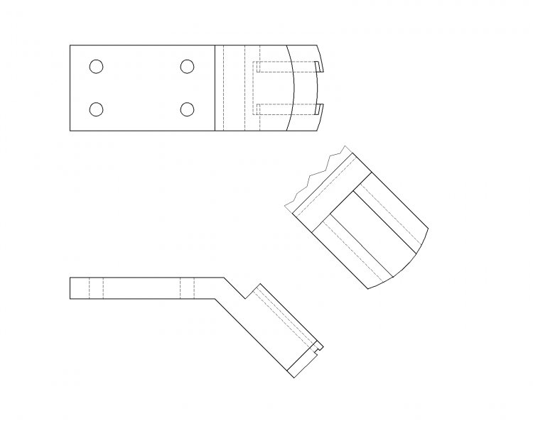

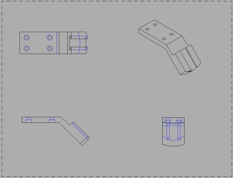

ReMark Posted December 12, 2012 Posted December 12, 2012 Maybe this will clear things up for you a bit. Of course that assumes I drew it correctly. If I didn't JDM will tell us both where I went wrong. Quote
Dadgad Posted December 12, 2012 Posted December 12, 2012 Looks pretty good to me ReMark, and I am sure you are glad you were able to model it, instead of drawing it. Much easier. I was hoping that the OP would rise to the bait and model it, would have been pretty easy once the front view was done, I thought I was going to walk him through it. Quote
ReMark Posted December 12, 2012 Posted December 12, 2012 By all means walk him through it. The OP would probably appreciate the verbal assist. Quote

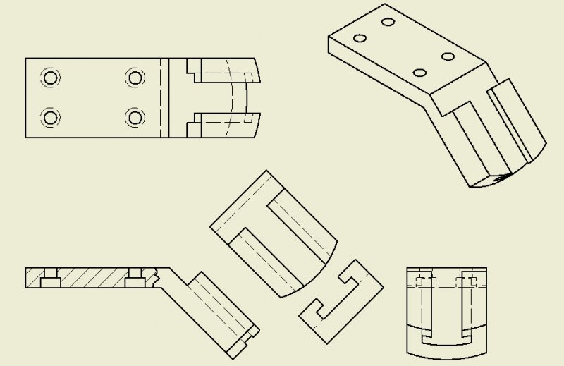

ReMark Posted December 12, 2012 Posted December 12, 2012 Maybe this will lure him back. Not 100% sure on the way I showed the holes. I'm a bit rusty when it comes to machining. Quote
SLW210 Posted December 12, 2012 Posted December 12, 2012 Technically speaking, you would need at least one section view straight on to the angled part of the bracket. Quote
ReMark Posted December 12, 2012 Posted December 12, 2012 OK. Why would that be? Remember...this is not the type of work I do on a daily basis. Or even monthly for that matter. Thanks. Quote
SLW210 Posted December 12, 2012 Posted December 12, 2012 To detail the T-Slot on the end. Same reason there is a seperate drawing for that in the text. Quote
ReMark Posted December 12, 2012 Posted December 12, 2012 Ahhhhh.....I see said the blind man to his deaf coworker. I should have had a V-8! Gotcha. Thanks. Quote
ReMark Posted December 12, 2012 Posted December 12, 2012 Would this be acceptable? I rotated the bracket to get a good head-on view of the right side. Quote
SLW210 Posted December 12, 2012 Posted December 12, 2012 That would be sufficient for me to machine the T-Slot, yes. Hopefully an instructor would feel the same way, odds are others will miss this necessary view. Quote
