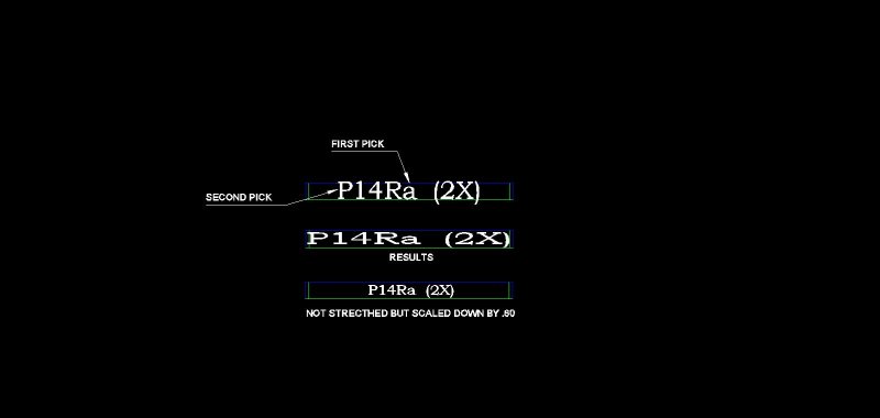

BrianTFC Posted January 7, 2013 Share Posted January 7, 2013 Hi All, I was wondering if there was a lisp routine out there that when you drop a dtext string into a rectanlge that it would shrink down to fit inside? I looked at the text fit command in the express tools but it only shrinks or stretches the length. Thanks, Brian Quote Link to comment Share on other sites More sharing options...

BrianTFC Posted January 14, 2013 Author Share Posted January 14, 2013 Henrique, I was wondering if there is way for the text to be scaled down to fit inside vs. stretched and shrinked to fit? Thanks, Brian TEXT SHRINK.dwg Quote Link to comment Share on other sites More sharing options...
Lee Mac Posted January 14, 2013 Share Posted January 14, 2013 Try this quickly written code: ([color=BLUE]defun[/color] c:tfit ( [color=BLUE]/[/color] ln pl pt tx ) ([color=BLUE]if[/color] ([color=BLUE]and[/color] ([color=BLUE]setq[/color] pl (LM:selectifobject [color=MAROON]"\nSelect LWPolyline: "[/color] [color=MAROON]"LWPOLYLINE"[/color])) ([color=BLUE]setq[/color] tx (LM:selectifobject [color=MAROON]"\nSelect Text: "[/color] [color=MAROON]"TEXT"[/color])) ([color=BLUE]setq[/color] pl ([color=BLUE]mapcar[/color] '[color=BLUE]cdr[/color] ([color=BLUE]vl-remove-if-not[/color] '([color=BLUE]lambda[/color] ( x ) ([color=BLUE]=[/color] 10 ([color=BLUE]car[/color] x))) ([color=BLUE]entget[/color] pl))) ln ([color=BLUE]length[/color] pl) pt ([color=BLUE]mapcar[/color] '[color=BLUE]/[/color] ([color=BLUE]apply[/color] '[color=BLUE]mapcar[/color] ([color=BLUE]cons[/color] '[color=BLUE]+[/color] pl)) ([color=BLUE]list[/color] ln ln)) tx ([color=BLUE]entget[/color] tx) ) ) ([color=BLUE]entmod[/color] ([color=BLUE]subst[/color] '(72 . 1) ([color=BLUE]assoc[/color] 72 tx) ([color=BLUE]subst[/color] '(73 . 2) ([color=BLUE]assoc[/color] 73 tx) ([color=BLUE]subst[/color] ([color=BLUE]cons[/color] 10 pt) ([color=BLUE]assoc[/color] 10 tx) ([color=BLUE]subst[/color] ([color=BLUE]cons[/color] 11 pt) ([color=BLUE]assoc[/color] 11 tx) ([color=BLUE]subst[/color] ([color=BLUE]cons[/color] 40 ([color=BLUE]*[/color] [highlight]0.8 [color=GREEN];; Text Gap[/highlight][/color] ([color=BLUE]-[/color] ([color=BLUE]cadr[/color] ([color=BLUE]apply[/color] '[color=BLUE]mapcar[/color] ([color=BLUE]cons[/color] '[color=BLUE]max[/color] pl))) ([color=BLUE]cadr[/color] ([color=BLUE]apply[/color] '[color=BLUE]mapcar[/color] ([color=BLUE]cons[/color] '[color=BLUE]min[/color] pl))) ) ) ) ([color=BLUE]assoc[/color] 40 tx) tx ) ) ) ) ) ) ) ([color=BLUE]princ[/color]) ) [color=GREEN];; Select if Object - Lee Mac[/color] [color=GREEN];; Continuously prompts the user for a selection of a specific object[/color] ([color=BLUE]defun[/color] LM:SelectifObject ( msg obj [color=BLUE]/[/color] ent ) ([color=BLUE]while[/color] ([color=BLUE]progn[/color] ([color=BLUE]setvar[/color] 'errno 0) ([color=BLUE]setq[/color] ent ([color=BLUE]car[/color] ([color=BLUE]entsel[/color] msg))) ([color=BLUE]cond[/color] ( ([color=BLUE]=[/color] 7 ([color=BLUE]getvar[/color] 'errno)) ([color=BLUE]princ[/color] [color=MAROON]"\nMissed, try again."[/color]) ) ( ([color=BLUE]=[/color] 'ename ([color=BLUE]type[/color] ent)) ([color=BLUE]if[/color] ([color=BLUE]/=[/color] obj ([color=BLUE]cdr[/color] ([color=BLUE]assoc[/color] 0 ([color=BLUE]entget[/color] ent)))) ([color=BLUE]princ[/color] [color=MAROON]"\nInvalid Object Selected."[/color]) ) ) ) ) ) ent ) ([color=BLUE]princ[/color]) Adjust the highlighted text gap if necessary. Quote Link to comment Share on other sites More sharing options...
BrianTFC Posted January 14, 2013 Author Share Posted January 14, 2013 Lee, That's exactly what i was looking for, after looking at your code i found the line that if i need to make the text smaller i can. I really do appreciate all the help i get from all of you on on CadForum. Slowly but surely i'm learning how to write small simple routines but i'm getting better at reading the codes and leaning what each line does through Visual Lisp editor, Henrique aka (hmsilvia) showed me how to animate the lisp routine so i can follow how it works. Thanks again guys, Brian Quote Link to comment Share on other sites More sharing options...
