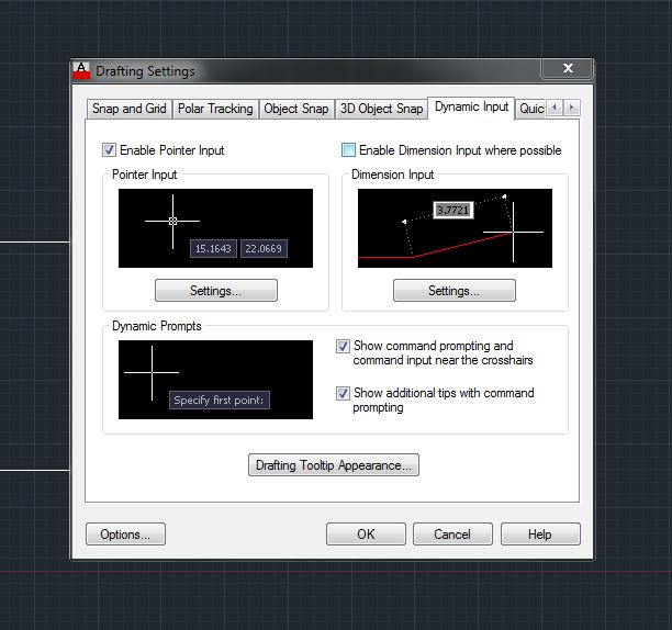

Jawo
I was actually aware of that Object Snap Tracking would have something
to to with my problem. I looked more into the Object Snap Tracking SETTINGS
(or Dynamic Input) when Dadgad mentioned it, and turned off and on the
"Enable dimension input when possible" option. AND THEN when I closed the
setting box, like a miracle from the almighty AutoGod, it was working.
This was obviously something that was just.. stuck.
Thank you for your help, guys! Now I can happily go on with my interior project : D
