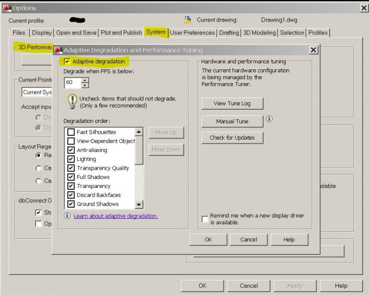

Dadgad Posted January 28, 2013 Share Posted January 28, 2013 What visual style are you using as you model? The fastest visual style you could use would be 2D Wireframe. You may want to, if you have not already, configure and activate your adaptive degradation. You can do that on the SYSTEM tab in OPTIONS, as shown in the image. It sounds like you have already done a manual tune, as shown on the right in the image? Quote Link to comment Share on other sites More sharing options...
danielk Posted January 28, 2013 Author Share Posted January 28, 2013 Already done.. Quote Link to comment Share on other sites More sharing options...

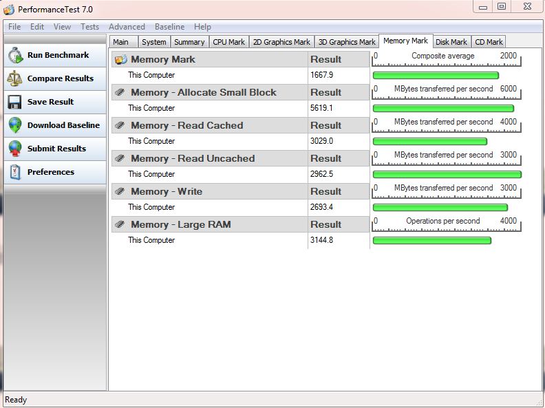

danielk Posted January 28, 2013 Author Share Posted January 28, 2013 how can i see the graphic card performence during 3d work ( as i mentioned its AMD FIREPRO V5900)? Quote Link to comment Share on other sites More sharing options...

ReMark Posted January 28, 2013 Share Posted January 28, 2013 Benchmark your system using the Cadalyst Benchmark text found here. http://www.cadalyst.com/benchmark-test Quote Link to comment Share on other sites More sharing options...
danielk Posted January 29, 2013 Author Share Posted January 29, 2013 What is this ERROR Quote Link to comment Share on other sites More sharing options...
