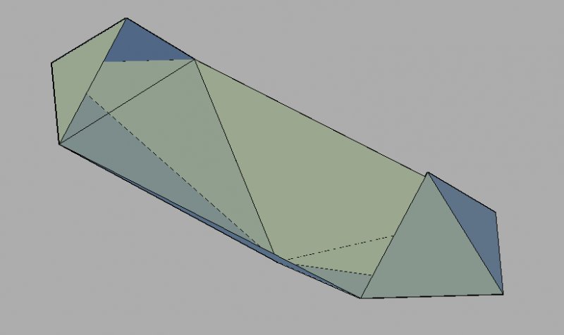

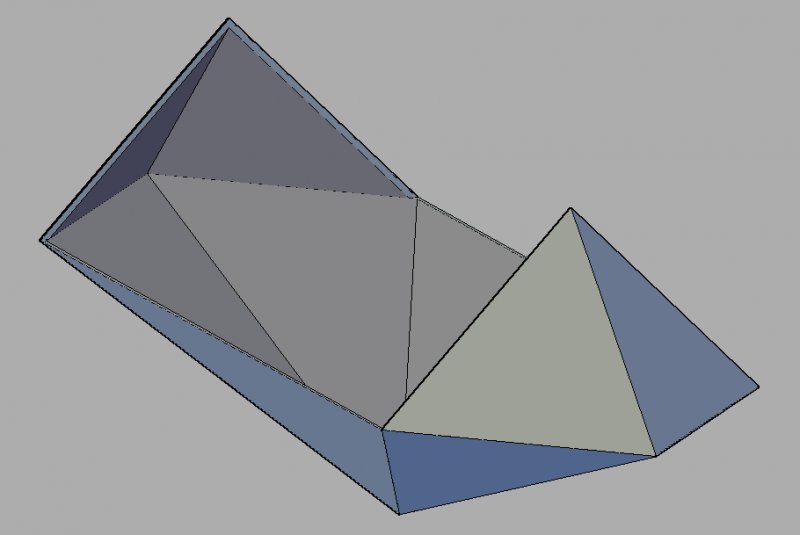

Is this kind of what you had in mind for your mystery object?
No, it is not a solid....yet.
[ATTACH=CONFIG]40245[/ATTACH]
yes it is.. how were you able to do that because that was one layer!
I used 3Dpolylines and the Region command if you must know.
Object depicted in Conceptual visual style. I elected to change the object's color.
Yes, it was one layer. Why does that surprise you?

Now that I think about it some more the object could probably be done a different way. The SHELL command comes to mind but first the gross geometry would have to be constructed as a solid. I'll give it some thought.

Most of the way there as a solid. Now it just requires a little magic to get the final results.
