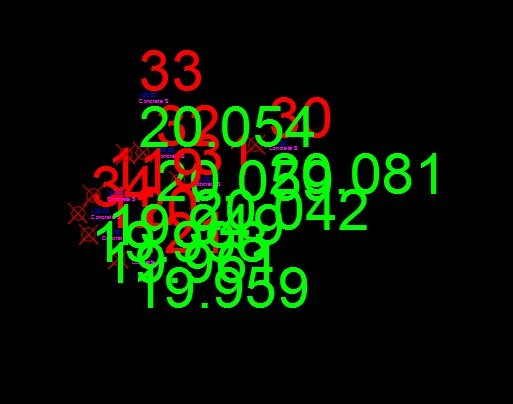

When reporting in Autocad, a file with points of the form: name, north, east, height, code, ... etc.
if distances between points are small, texts name and height point, overlap. How to detect and how to avoid these overlaps.

Select all the text and change the text height into smaller..

This is not a solution, I need to be writing with specific height.

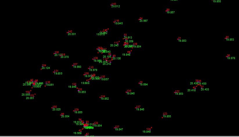

My idea is to :
1. arrange the points list by E or N E1 < E2 < ... < En ;
2. calculate the distance between closest points and if it is smaller then text dimension , then rotate the last one with 180° , or change the justify of text .
But is maybe 50% right , after 1 iteration .
Maybe after few iterations , will be better .
See what 'Organic' said .
I am using a manual tool to move / arrange the texts / attributes around the point  and if it is necessary , to make the attributes invisible .

The term fuzzy logic comes into play, some software does this but not Civ3D, the problem is you move or rotate 1 then it hits another, so need idea 3 and go to leader moving away, like constinboss77 for years have just lived with it and played with the text when needed. It is not just points and hts etc but station control tbms etc set to readable and see what happens when between a layout and the next rotate ucs 90, so roads plotted horizontal on every sheet, had to find an average spot so could read on say 2 layouts.

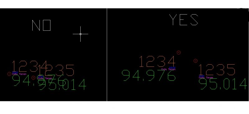

Yes , at the end is not really a problem .
1. Leader solution can be considered if it is enough space around to play ;
2. or , if it is really to busy , hide the text and keep the point symbol ;
But , I am doing this only in manual way  (point by point ) . Unfortunately , not all the tasks can be solved automatically
The problem is the scale of points is not correlated with the density of survey , because usually , the distance on the paper at any scale between 2 point is  20 mm .
And in this example , this rule was omitted .
But , i don't know if 'miha' is asking exactly for this problem or a general overlay  between texts on a drawing .
