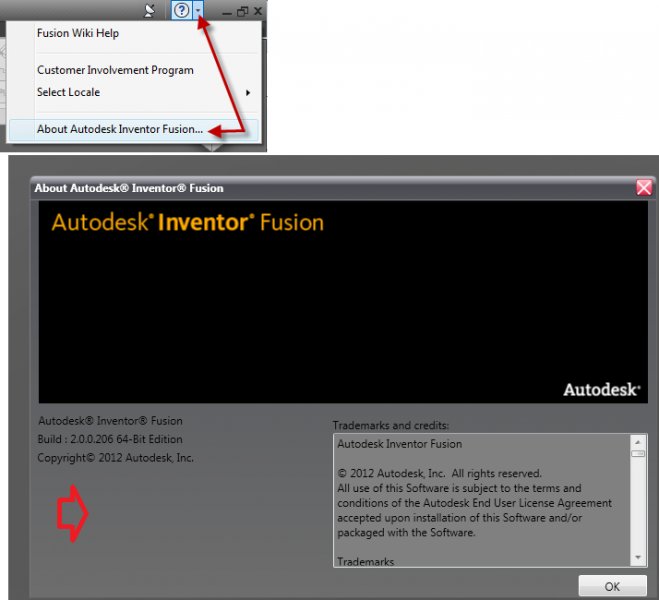

JD Mather Posted April 17, 2013 Share Posted April 17, 2013 (edited) Do you know of any reason why I can't do that? Start Fusion. Go to Help>About Autodesk Inventor Fusion Does it report as the License Expiration date? Edited April 17, 2013 by JD Mather Quote Link to comment Share on other sites More sharing options...
uraniumtiger Posted April 17, 2013 Author Share Posted April 17, 2013 Hi JD Mather, I have Inventor Fusion open but I don't see a help page or button anywhere. I tried clicking F1 but that takes me to a webpage. Quote Link to comment Share on other sites More sharing options...
uraniumtiger Posted April 17, 2013 Author Share Posted April 17, 2013 No wait, I found a help page. I need to read through the text as it appears long. I will see if there is a product expiration date. Quote Link to comment Share on other sites More sharing options...
JD Mather Posted April 17, 2013 Share Posted April 17, 2013 No wait, I found a help page. I need to read through the text as it appears long. I will see if there is a product expiration date. It should be real obvious if there is an expiration date. Quote Link to comment Share on other sites More sharing options...
uraniumtiger Posted April 17, 2013 Author Share Posted April 17, 2013 Yes, this is where I was reading. When I copied the text out and pasted it into an MS Word file it was 33 pages long. 33 pages of legalese. I am reading it and I am about half way through. So far there is no sign at all of an expiration date. It is just one contributing software author after another saying that they give permission to use the software provided the copyright notice and the list of conditions is retained in the software code. I will get back to you when I finish reading through this. Quote Link to comment Share on other sites More sharing options...
uraniumtiger Posted April 17, 2013 Author Share Posted April 17, 2013 Hi JD Mather, I just read through the entire document (or I skimmed through it). I did not see any mention anywhere of an expiration date for the software. I guess that means I can use the product indefinitely. Do you think that is right? -Uraniumtiger Quote Link to comment Share on other sites More sharing options...
