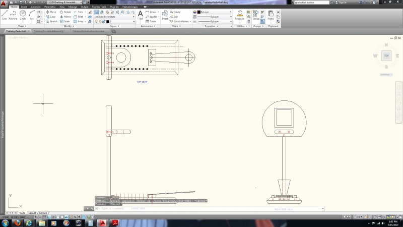

cosme017 Posted July 3, 2013 Author Posted July 3, 2013 Again, I'm unfamiliar with the project, so your question is a little confusing from my perspective, that is, I also would have thought you'd already drawn everything, if you are at the point to make an assembly drawing. But, in any case, for an assembly, you just take whatever components you've drawn, they could be subassemblies rather than individual parts, and put them all together for a complete assembly. Of course, this means you need everything there. If there's something you didn't draw, you will need to add it. Did you draw this in 3D? Or are you just drawing with lines, etc, in orthographic projection? I am drawing the orthographic projection. (3 views) And no I am not finished drawing the three views. I'm a beginner so give me a break. Everyone is always questioning my progress. I can't be on autocad 24/7. Not that I got that out of the way, I am going to post the project picture up, and I hope I can get an idea on how to draw an assembly drawing. There seems to be too many parts to draw out. Quote

ReMark Posted July 3, 2013 Posted July 3, 2013 The project is a toy basketball hoop with a device for launching an appropriately sized ball. It consists of a base, "catapult" arm, a pole, backboard, and rim. The student was provided with rough approximations of the three standard views. Parts of the toy are held together with small screws. I think the most difficult parts for the student would be the screws. I would guess that a student that has gone through all the standard Penn-Foster projects, many of which have been discussed in this forum, could knock out the three views in three hours or less if they did not take an extended vacation of AutoCAD after finishing the first set of projects. Individual, fully dimensioned, part drawings would of course require more time to complete. That goes for an isometric, if required, as well. That's why at the very start I suggested doing this all in 3D and extracting the necessary views from the 3D model. Quote

cosme017 Posted July 15, 2013 Author Posted July 15, 2013 Ok, here is the preliminary 3 views. I'm onto drawing the section view for the rim and backboard. Any suggestions, without using 3d? TabletopBasketball.dwg Quote
ReMark Posted July 15, 2013 Posted July 15, 2013 Most of the geometry for the sectional view can be taken directly from what you are calling your Front view. In my opinion, the view in the lower right hand corner would be the Front view but that means you would have to rotate your Top view. Using paper space layouts for this drawing? I'd recommend a separate layer for your Viewport(s) set to "no print" in the Layer Properties Manager. Just a suggestion. Quote
cosme017 Posted July 15, 2013 Author Posted July 15, 2013 1. Ok but I need to draw a sectional view just for the rim and backboard showing the screw attachments. 2. I can change the views, that shouldnt be an issue., and 3. I'm not sure what you are saying about the paper space layout. What would that layer do? So for the rim and backboard, I was going to just show an exploded view of the rim and backboard alone. That's not what I should go for? Quote
ReMark Posted July 15, 2013 Posted July 15, 2013 Unless otherwise stated a sectional view would be of the whole object (rim, backboard, post, base, etc.). Were you explicitly told to use a paper space layout and one or more viewports? Yes or No? An exploded view of just the rim and backboard would not be the same as a sectional view. You do know what a "section" through an object would entail right? Imagine a Twinkie that you cut in half and you look head on at the cut end. You'd see the cake and the filling. That's a section. Quote
