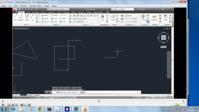

the picture with a circle surrounding a dot the one i did with @4
and the other picture is the original one i watched.

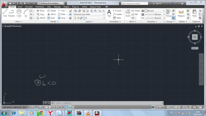

mine.jpg[/ATTACH]

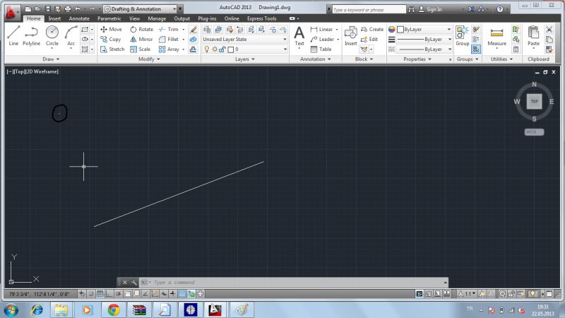

after choosing an acadiso for metric and setting the units for length to architecture and inches and precision to 0' 01 /16''' as you said
mine line is as small as a dot for @4
big enough line.the problem perplexing me here is is it just a zoom problem
or it is about mine unit settings?.i think this time i expressed the problem
clearly.
Yes, you expressed it clearly.
Now let me do the same.
You used the wrong template. It is not a good idea to use a metric style template then turn around and specify imperial "architectural" units. Likewise, it would not be a good idea to start with an imperial style template and specify metric units. One should try to avoid these types of conditions as it will only cause confusion for the user and frustration for anyone he/she may share the drawing with. If you require both imperial and metric dimensions to appear on a drawing there is a much better way to do so.

If you want to ultimately dimension a drawing in feet and inches (architectural units) then start a new drawing using the acad.dwt template. I'm pretty sure I have said this more than once in this thread. Please follow my advice.
i made it architectural ,precision 0'-01/16'' and the units inches but it is
still too small

it's right you've said it in the first page.the problems has been solved and unfortunately it was a simply one.this time i succeed it,i have a ultimately long line with architectural inches on acad.thanks for everything.
