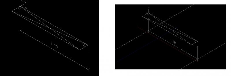

mech
RobDraw,
Here's a quick Image to show the "broken" Blocks
The Image on the left is the original 3D Block with the 3d part hidden. For whatever reason when I drop it into this drawing (and only this drawing) the "/" left and right on the 1,20m Dimension turn into some sort of a construction lines that run to the end of the drawing.... and possibly beyond.....
to fix this i have simply opened the block in block editer, exploded the dim and copied self made "/" into Position.

RobDraw
That is probably not a problem with the blocks and exploding dimensions is a workaround, not a fix. I would never recommend exploding a dimension in this situation. More than likely it's something to do with the arrow head settings in the dimension style or the block for that arrowhead if it is a custom one.
That being said you are probably not fixing the original issue. I can't see how that would cause the problems you were having. It obviously needs to be fixed, though. Whoever said that having blocks within blocks is a bad thing was totally mistaken. I've worked with thousands if not 10's of thousands of blocks that have other blocks in them. If properly constructed, they do not cause problems. If the problem lies in the blocks it is because of bad CAD, not because of nested blocks.
