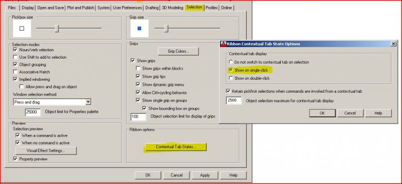

maddog1995 Posted June 17, 2013 Share Posted June 17, 2013 A co-worker is having issues when using the ribbon tools in 2013. It seems that he has to click the tool twice to activate it. Has anyone else encountered this problem? And if so, how can we set it so he has to click the tool only once. I've searched the different variables, but none of them seem to have any effect, so far. Thanks. Quote Link to comment Share on other sites More sharing options...
Dadgad Posted June 17, 2013 Share Posted June 17, 2013 I don't use the ribbon, not sure that this will help you, but it is worth considering. I am guessing that you used SYSVDLG when searching for possible variable based fixes? If not that is how I would suggest doing it. Quote Link to comment Share on other sites More sharing options...
maddog1995 Posted June 19, 2013 Author Share Posted June 19, 2013 Thanks Dadgad. I think that took care of the problem. Just another one of these settings that for some reason was different on his computer than everyone elses. I don't think I'd have ever found that setting without your help. Quote Link to comment Share on other sites More sharing options...

Dadgad Posted June 26, 2013 Share Posted June 26, 2013 Thanks Dadgad. I think that took care of the problem. Just another one of these settings that for some reason was different on his computer than everyone elses. I don't think I'd have ever found that setting without your help. Glad to hear that did the trick. There is plenty I don't know about the software, but I am by nature quite curious, and just about whenever I see something titled advanced options or similarly, I can't help but take a look. It is impossible to optimize the performance of the software to suit our own needs, if we don't first explore all of the available options. SYSVDLG is extemely helpful for this, as it makes us aware of optional behaviors which may be better suited to one's personal needs than the default OOTB settings. Quote Link to comment Share on other sites More sharing options...
