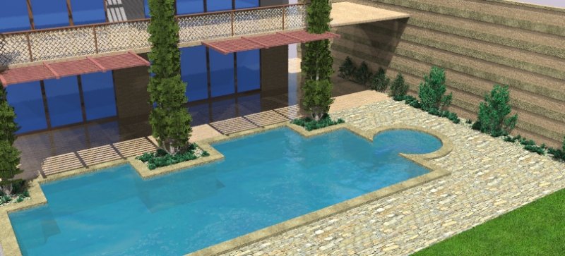

Cad64 Posted June 23, 2013 Posted June 23, 2013 Can you provide some information about what you want help with? I assume you want to add backgrounds to those videos, but are you planning on rendering out some good quality animations or are you just going to stick with those simple viewport screen grab recordings? Quote
ntptorres Posted June 23, 2013 Author Posted June 23, 2013 Yes...i need more inf. To refine my animations, what about a background on the animation, how can i inprove that.... Any hints...??? Here i include a drawing made in autocad 2013 and redered with accurender nxt b318 my animation are too dark i need a backgoriundquality material ( brick, foliage, flowers) Quote
Cad64 Posted June 24, 2013 Posted June 24, 2013 The first thing I would recommend is to add a daylight system and enable final gather in your indirect illumination render settings. That will make a huge difference. Quote

spittle Posted June 28, 2013 Posted June 28, 2013 Long "around the world" camera moves tend to be distracting. Slow controlled movements with cuts between them would be an area that you could improve. Quote

Cad64 Posted June 29, 2013 Posted June 29, 2013 You have already asked this same question twice before, so I have merged all 3 threads into this one. Please don't start another thread asking the same question. Just continue on in this one. If you're looking for realism then you need to add a daylight system, as I've mentioned twice before. There are no shadows anywhere in your video so it just looks like a bad cartoon. Add a daylight system and enable final gather. Quote

sigaukedenn Posted November 3, 2013 Posted November 3, 2013 i would side with cad64, may you just say yes or no if you have tried his ideas, if yes then please highlight it, because it would be a total waste of your time and those wanting to help. if you want you can go to advanced materials pallete and double click your material and then adjust it to the way you would want it so as to show the brickwork much better, then on your advanced rendering pallete put the settings that cad64 has suggested, with respect to shadows go to the advanced sun settings and reduce the intensity factor until your shadows are transparent enough, and then your drawing will have the effect you seek. Quote
Cad64 Posted November 6, 2013 Posted November 6, 2013 if you want you can go to advanced materials pallete and double click your material and then adjust it to the way you would want it so as to show the brickwork much better, then on your advanced rendering pallete put the settings that cad64 has suggested, with respect to shadows go to the advanced sun settings and reduce the intensity factor until your shadows are transparent enough, and then your drawing will have the effect you seek. Sigaukedenn, you have replied to a question in the 3D Studio Max section. There is no "Advanced material palette", "Advanced rendering pallete" or "Advanced sun settings" in Studio Max. Those are Autocad features. Please be aware of what section of the forum you are in before responding to questions so as not to provide incorrect or misleading information to those looking for assistance. Thanks Quote
