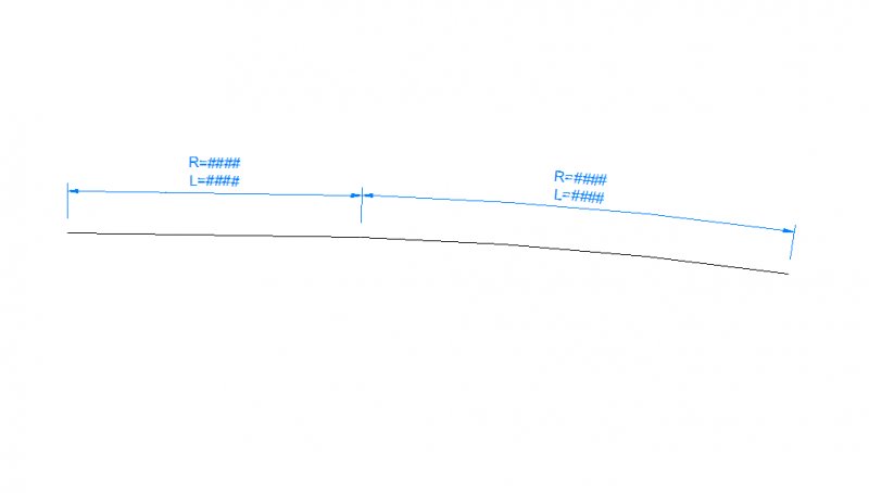

woohhoo Posted June 25, 2013 Share Posted June 25, 2013 Hi guys I just had an upgrade of Autocad 2010 to 2013. However, a very important lisproutine doesn't work properly anymore. What has happened? Can someone help me please? With the lisp I can select several arcs (not polylines!) and when I enter the length and the radius appeares above the selected lines. ARCRLVOOR_DimVoorSnijden.lsp Thx. Quote Link to comment Share on other sites More sharing options...
Tharwat Posted June 25, 2013 Share Posted June 25, 2013 It works here . What is the error report that you receive at the command line ? Quote Link to comment Share on other sites More sharing options...
woohhoo Posted June 25, 2013 Author Share Posted June 25, 2013 This is what I get. No values, only ####. When I worked with Autocad2010 I didn't had that problem. Quote Link to comment Share on other sites More sharing options...

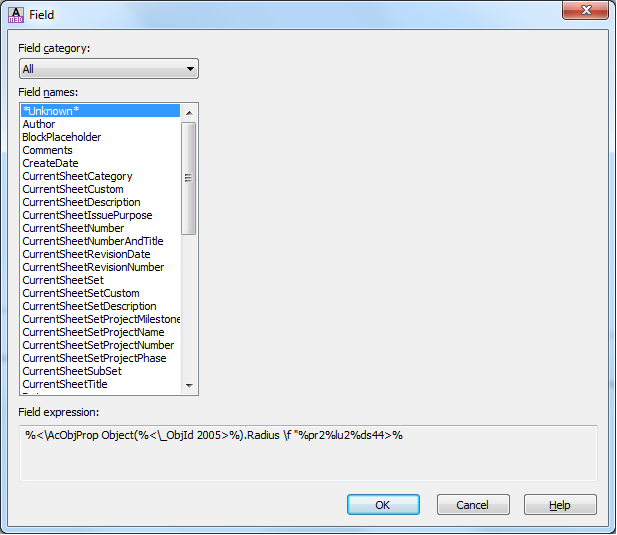

woohhoo Posted June 25, 2013 Author Share Posted June 25, 2013 And this is what I get when I open the fieldbox. Quote Link to comment Share on other sites More sharing options...

pBe Posted June 26, 2013 Share Posted June 26, 2013 Perhaps this (defun LM:GetObjectID ( doc obj ) (if (vl-string-search "64" (getenv "PROCESSOR_ARCHITECTURE")) (vlax-invoke-method (vla-get-Utility doc) 'GetObjectIdString obj :vlax-false) (itoa (vla-get-Objectid obj)) ) ) (setq id (LM:GetObjectID (vla-get-activedocument (vlax-get-acad-object)) arcobj)) (setq radstr (strcat "R=%<\\AcObjProp Object(%<\\_ObjId " id ">%).Radius \\f \"%pr2%lu2%ds44>%")) (setq lenstr (strcat "\\PL=%<\\AcObjProp Object(%<\\_ObjId " id ">%).ArcLength \\f \"%ct8[1000]%pr0%lu2%ds44>%")) Quote Link to comment Share on other sites More sharing options...
woohhoo Posted June 26, 2013 Author Share Posted June 26, 2013 Perhaps this (defun LM:GetObjectID ( doc obj ) (if (vl-string-search "64" (getenv "PROCESSOR_ARCHITECTURE")) (vlax-invoke-method (vla-get-Utility doc) 'GetObjectIdString obj :vlax-false) (itoa (vla-get-Objectid obj)) ) ) (setq id (LM:GetObjectID (vla-get-activedocument (vlax-get-acad-object)) arcobj)) (setq radstr (strcat "R=%<\\AcObjProp Object(%<\\_ObjId " id ">%).Radius \\f \"%pr2%lu2%ds44>%")) (setq lenstr (strcat "\\PL=%<\\AcObjProp Object(%<\\_ObjId " id ">%).ArcLength \\f \"%ct8[1000]%pr0%lu2%ds44>%")) Yes, problem solved!! This works great. Thank you very much, pBe!! Also thx to everyone who worked on this problem too Quote Link to comment Share on other sites More sharing options...
