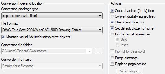

eldon Posted June 27, 2013 Posted June 27, 2013 This from Dwg TrueView. I am sorry but I do not see the option to explode anything Quote

eldon Posted June 27, 2013 Posted June 27, 2013 Eldon, I am a surveyor and I need to create offsets for the geometry. I have tried to the new drawing, xref thing but I don't get all the geometry in the xref for some odd reason? When you x-ref the drawing in, do you get any message about Proxy graphics being enabled? If you cannot see the necessary geometry, then you must contact the originator, and possibly they will be able to Export to r2000. I tried to download version 4.5 in microsoft net but it said my computer does not support that file. Yes I had that problem with my old computer, but it died last year, and the new computer was more modern and was able to handle things better. Quote
