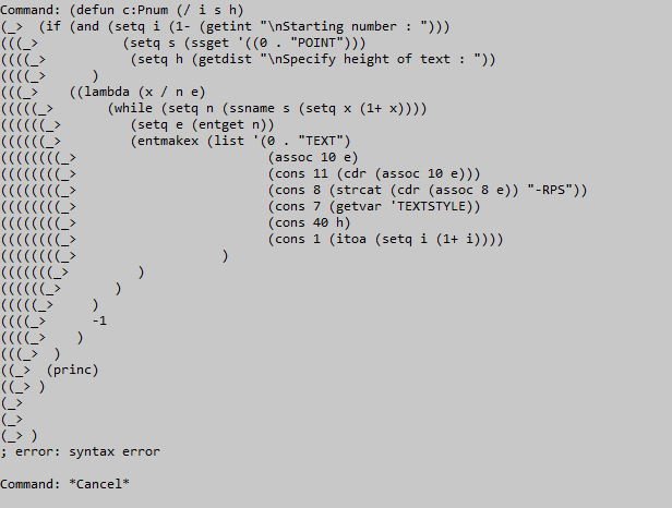

'error'.
That will help us work out what is wrong. What error are you getting?
Thanks for the response, below is a snap
Just put under line :
(cons 1 (itoa (setq i (1+ i))))
(cons 62 256)
