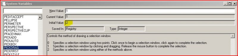

eldon Posted July 9, 2013 Posted July 9, 2013 Have you tried setting the system variable PICKDRAG to 1? It defaults to 0. Quote

Dadgad Posted July 9, 2013 Posted July 9, 2013 Have you tried setting the system variable PICKDRAG to 1? It defaults to 0. I believe that in recent releases the default value has been changed to 2. Quote

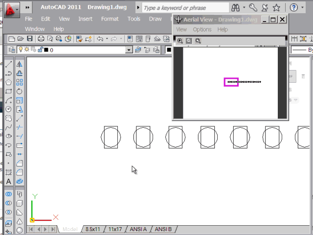

nestly Posted July 9, 2013 Posted July 9, 2013 In the following example, how would I use DSVIEW to select all the circles, but not the rectangles? As far as I can tell, objects that are windowed, but not in the main display are not included in the selection set, just like using the built in transparent zoom/pan Quote

ReMark Posted July 9, 2013 Posted July 9, 2013 (edited) Setting PICKDRAG to 1 and picking the circles individually would work but it would also be more of a PITA. I used the feature back when it was solely an exclusive feature of graphics cards and software produced by a company called nth Engine. However AutoDesk bought them out and decided to start messing with it (i.e.- they screwed it up). I continued to use it for a couple of years afterwards then finally gave up. Update. Using AutoCAD 2014 where PICKDRAG can be set to 2 also does not work. Guess it is back to the think tank. Sorry about that guys. Edited July 9, 2013 by ReMark Quote

ReMark Posted July 9, 2013 Posted July 9, 2013 Interesting. Actually it does work in an odd sort of way. The user would have to zoom in and build individual selection windows around all the circles he/she could see at one time on their screen then change the view (via the aerial view) to another portion of their screen and do it again. This is not how it worked when nth Engine designed the program. Trivia: nth Engine was located in Texas. The software required a dongle. The cost of an nth Engine graphics card with the aerial viewing software was $3000. This was back in 1985. Quote
ReMark Posted July 9, 2013 Posted July 9, 2013 OK...confirmed using AutoCAD 2014. My test was a similar rectangle and circle that I arrayed in 12 columns and 12 rows (144 rectangles/circles). I ran the test using the Move command. Using the aerial viewer I zoomed in on the four bottom rows and built individual windows around the circles in each of the first three rows (a window captured 12 circles). Switched my view so I could see the top four rows and did the same thing for three of the four. So now I had selected selected 3x12x2 or 72 circles. Finished the Move command by dragging everything way off to one side. All 72 circles came along for the ride. Bottom line. It works but you need a certain "technique" to get the desired results. Is it perfect? Probably not but it will do in a pinch. Quote

ReMark Posted July 9, 2013 Posted July 9, 2013 I can replicate the same behavior without using the aerial view just relying on my scroll button to zoom in and out of my drawing. Variables set as follows: PICKFIRST=1 PICKADD=2 PICKDRAG=0 Quote
