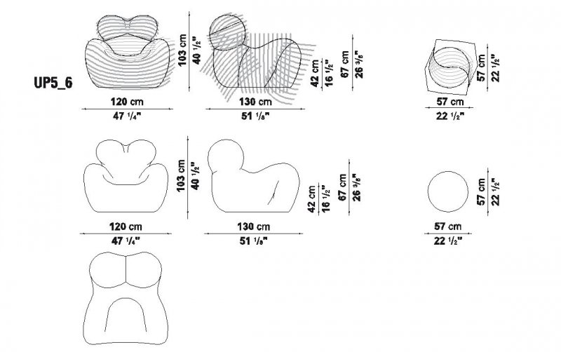

Khaleesi8 Posted July 12, 2013 Posted July 12, 2013 Hi everyone, I am a beginner with Autocad 2D and I have a problem with some of my imported blocks. They appeared way too small. I've read the other post about the subject, but it didn't work for me. I downloaded a couple of .dwg file in 2d on a manufacturer website. Then I inserted them in my drawing, and they are tiny. I've tried the trick to scale it at 25.4, but they are still a little bit too small. I've also tried to set INSUNITS to 0 or 1 and didn't change anything.... The problem seems only to appear with this company. Other blocks from other company seems fine. Anyone has an idea of the problem? Thank you so much Quote

ReMark Posted July 12, 2013 Posted July 12, 2013 So you are using imperial units but you are working with metric blocks? Well anyway, just measure the distance of the known side and compare it to the size it should be. Example: if your measurement comes back as 4 inches but you know the true dimension is 12 inches then the scale factor you must apply would be 3. Simple math. Quote
nestly Posted July 12, 2013 Posted July 12, 2013 I believe INSUNITS only works if the block is also assigned units ie not 'unitless' As for scaling there is no need to calculate a scale factor, just use SCALE > Reference. If you want to post the block, and a known dimension, I'll do a video demonstration using your block/object Quote
Khaleesi8 Posted July 12, 2013 Author Posted July 12, 2013 I have no idea if it it metric or imperial block. On the website, they give us the 2 dimension (cm and inches) But you had a good idea and it works fine! Thank you so much, it's been hours I try to fix this. Quote

ReMark Posted July 12, 2013 Posted July 12, 2013 It scaled fine for me using the Reference option as nestly suggested. Quote
