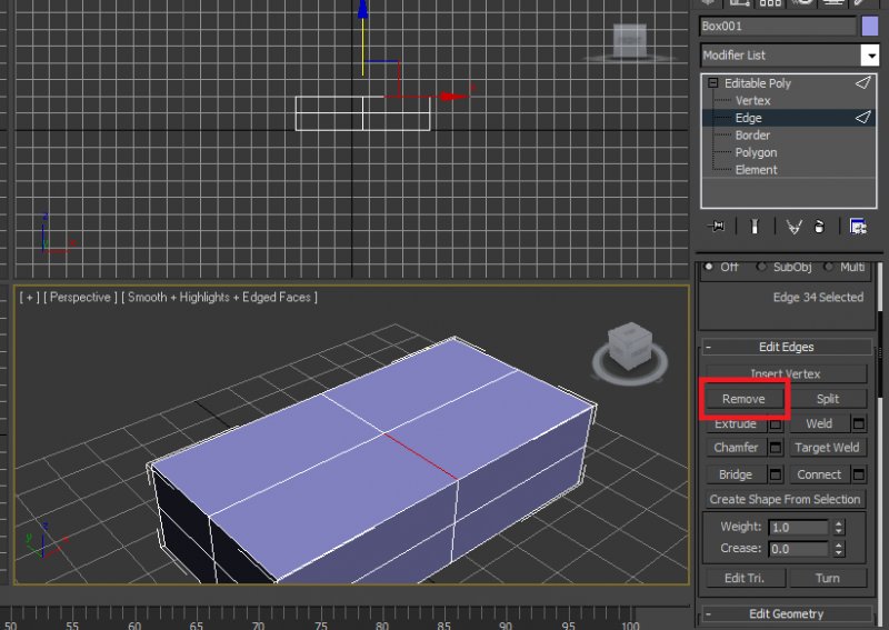

having an editable polygon, and on top side of the polygon; making the rectangular loop edge inset and then extruded.
how can I then apply the same to the object on bottom !?
- symmetry the object on z axis ?
after doing the symmetry, we have 2 polygons now, which for general editing I have problems with. How can I make these 2 into one !? (I'm not expecting grouping solutions, it's not really a good choice for further edits)
@niegrau - if my comprehension is right & and if this is for 3ds Max. Try selecting all the polygons that you wanted to place the inset,after the inset, while those polygons still selected click on extrude to apply same extrusion at the same time, ,then after symmetry modifier, convert the object to editable poly again,(the modifier will collapse to the new sub object level which is editable poly) from there, go to graphite modeling tools,select your object, got to sub-object level EDGES, select the EDGES that divides the 2 Polygons that you wanted to combine into one, then click on "Remove" this will remove the edges and the 2 Polygons is now combined into One Polygon. Also you can access "remove on the side Tool Panel under Edit Edges. Please see the picture below for your reference. Hope this helps.Regards

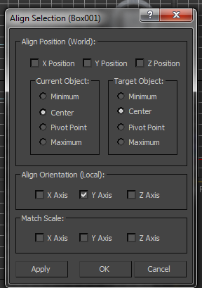

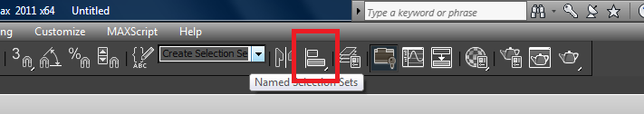

can I align any of them to another by Alignment tools ,rather than rotations?
4214948993_b.jpgView Screen Capture
@niegrau - Yes Align can do the trick. You may try the "Align". Make sure no any sub object level is selected(Vertex,Edges,Polygons etc.).To deselect any objects, simply click on the empty space in viewport. Click the rotated object first(the one with angle)then click "Align", then click the second object, a window will pop out, Make sure the Align position is Center to Center" and Align Orientation "Y" Axis is selected. It will align to the target object. If you want, you may try to play with the Align orientation and see how it works for you. Refer to picture below for reference.Regards
