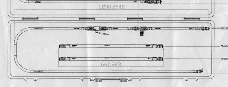

iainlines Posted September 25, 2013 Posted September 25, 2013 Hi all, Is there any way I can bend a 2D object? I have a drawing of a hydraulic hose running straight in the x axis. What I want to do is to be able is to bend the hose around 90 degress (to fit in a case) without altering the overall length & width. Poor explanation but hopefully someone will be able to give me an answer I have attached a simple drawing that should explain the problem. I know the lengths don't match, this is purely for illustration Thanks Hose.dwg Quote
ReMark Posted September 25, 2013 Posted September 25, 2013 Sounds like a job more suited for Inventor (i.e. - Tube and Pipe package of Inventor Professional). Do you know what the minimum bend radius is for the hydraulic hose you have selected? Quote
iainlines Posted September 25, 2013 Author Posted September 25, 2013 I should probably clarify.....I'm not actually drawing the hose itself, just the packaging (cnc machined foam) that it will go in. I would like to get it around 100mm radius. I have files of the shapes layed flat but I need to get them within the confines of the packaging ideally without a lot of re drawing as time is against me Cheers for the quick reply, as ever Quote

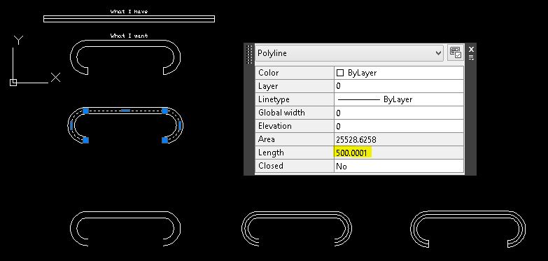

Dadgad Posted September 25, 2013 Posted September 25, 2013 Hi all,Is there any way I can bend a 2D object? I have a drawing of a hydraulic hose running straight in the x axis. What I want to do is to be able is to bend the hose around 90 degress (to fit in a case) without altering the overall length & width. Poor explanation but hopefully someone will be able to give me an answer I have attached a simple drawing that should explain the problem. I know the lengths don't match, this is purely for illustration Thanks ReMark is correct, Inventor could do it easily, but you can fake it, if all you need is a graphic representation in Autocad. Quote
iainlines Posted September 25, 2013 Author Posted September 25, 2013 Thanks Dadgad, but I don't think I'm being very clear. The lengths DO need to match....they just didn't in the quick sketch I knocked up. I want to take a rectangle and bend it without altering the length or width. Possible? Quote
Dadgad Posted September 25, 2013 Posted September 25, 2013 Thanks Dadgad, but I don't think I'm being very clear. The lengths DO need to match....they just didn't in the quick sketch I knocked up. I want to take a ractangle and bend it without altering the length of width. Possible? I scaled and offset from the centerline of your sample hose, so that the length of the centerline of the new hose, and the OD are the same as the straight sample. Perhaps you want to use parametric constraints to constrain the bent x or y lengths too? Quote
iainlines Posted September 25, 2013 Author Posted September 25, 2013 What I would like in an ideal world would be to draw what I need to straight acorss the X the bend it to produce something like the attached Quote

iainlines Posted September 25, 2013 Author Posted September 25, 2013 According to my customer, yes. Hoses and various valves To be fair they are not in the least delicate but this is a job that has been done before by competitors of ours and the customer insists this is the design they want. The screenshot shows an old design...all I have is hardware and a tape measure. Tricky and time consuming Quote

SLW210 Posted September 25, 2013 Posted September 25, 2013 Just determine the Arc length of your radius and that's the centerline length, any other allowances would be determined by the properties of the hose for compressing and stretching while bent. For most things the centerline usually works out close enough. 2π100(180/360) = 1256.637 (using your 100mm Radius suggestion) where: C is the central angle of the arc in degrees R is the radius of the arc π is Pi, approximately 3.142 P.S. I agree with using something more along the lines of Inventor or Solidworks, there are some third party apps for AutoCAD as well. I did have a trial version for something I think called 3DPipe, but never used it and I removed it last week. Quote

nestly Posted September 25, 2013 Posted September 25, 2013 Perhaps use a pline with the properties palette open so you can monitor the overall length while you experiment with different configurations? Quote
