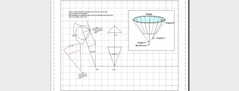

Bill W Posted September 25, 2013 Author Posted September 25, 2013 Yes, that was my first post but not my last, did not know you folks were so much fun. I'm using Acad Lt 2011. My current woodworking project includes angled, tapered, beveled, staves; kind of like building a barrel where nothing is square. I developed trigonometric equations to calculate the angles, so did some of my friends, and we all disagree on what is correct! So I'm going to use ACad to verify the equations, but need the true size and angle auxiliary views. There should be an attached file with my first simple attempt. Or no there will be no file - the uploader just kept running for 20 minutes. Will attach when I figure out what I'm doing wrong. Bill Quote

Bill W Posted September 26, 2013 Author Posted September 26, 2013 One file was .dwg, 434kb, the other a .pdf. Here is a .jpg (hope it works). Nope, no barrel yet, just a few flower pots for my wife so far (see photo). Others make shallow ones that they turn on a lathe to make nice bowls. Quote
steven-g Posted September 26, 2013 Posted September 26, 2013 Bill, sorry I couldn't read the dims on the image, as suggested using the UCS command to move about is the best method, LT doesn't have the built in tools to make it easier so you have to adjust it by inputting angles (though the UCS grip feature -2012 and newer- makes it better). How are you drawing it at the moment. I think there are web site calculators for this sort of thing, try looking for crown moulding or compound bevel calculators. Attached is a model showing how I would go about it, but the angles will alter depending on your sizes. Can you try and attach your file - maybe try dropbox or something similar if it's too big. PlantPot.dwg Quote

Bill W Posted September 26, 2013 Author Posted September 26, 2013 Steven, the dwg file is only 434 kb; I still can't get it to upload. Is there a way I could send it directly to an email, or is that verboten? I have looked at websites that have tables for some angles. Have to admit, however, that this has become a challenge to learn the method of doing the calculations, and now to re-learn auxiliary views on ACad. I don't do things the easy way. Will look at your attachment after breakfast. ReMark, no, there is no usual number of staves. The only variables are no. of staves and cone angle. The flower pot in the photo is 8 staves and cone angle of 20 degrees. My friend in Argentina makes bowls with 16 or more staves. Potguy, the files I try to upload are small. Photo attachments work fine. Quote
steven-g Posted September 26, 2013 Posted September 26, 2013 Bill sent me the dwg per e-mail I'll attach it here for any interested parties, I have no idea why it wouldn't work for him (PS its student version) Duelas.dwg Quote
