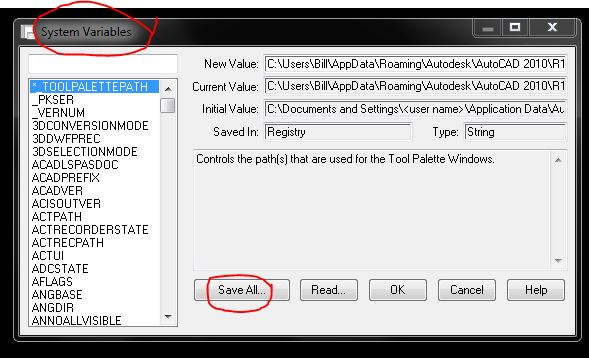

isutheparambil Posted October 6, 2013 Posted October 6, 2013 Dear all, Pl. some one can tell me about the problem i am facing now in my office pc, that in my user while i am open any drawing i need to change all system variables each time. ie, i need to reset zoom factor, mbuttonpan etc ... in each drawing. if i read the svf file saved from other pc also getting the same problem while open the next drawing.pl. give me a solution to solve this issue if some one knows about this issue. Quote

ReMark Posted October 6, 2013 Posted October 6, 2013 I came across this at Shawn Hurley's website. Two files, defaults.svf and defaults.scr, are installed in the Express directory along with the System Variable Editor. These files contain AutoCAD's the default system variable settings for a new installation of AutoCAD. To return AutoCAD to a 'pristine' system variable state you can either read the defaults.svf file into SYSVDLG or run the defaults.scr file from the AutoCAD command line using the SCRIPT command. Be aware that this will overwrite any system variable settings in the drawing you are currently editing. Quote

isutheparambil Posted October 6, 2013 Author Posted October 6, 2013 Dear, from where i can save the file defaults.scr....pl. explain how can.. svf file i can from express tool. but how can i save a scr file..pl. let me know.... Quote
ReMark Posted October 6, 2013 Posted October 6, 2013 Go to Express Tools > Tools > System Variable Editor. Or you can type sysvdlg at the command line then press the Enter key to open the same window. Are you running any script files? If two computers are being affected then something is causing it. Quote
isutheparambil Posted October 6, 2013 Author Posted October 6, 2013 Thank you..for your prompt replay.. but the thing as u told, i done it , unfortunately when i open the next drawing ...the same issue found.. this is something different.. i load from express both svf and scr files as u told. but that is effecting only the present drawing only. when i open an other file, it is same as before,... Quote
ReMark Posted October 6, 2013 Posted October 6, 2013 Then try this. Shut down AutoCAD completely. Then restart AutoCAD. Open a new drawing. Either load the default.svf file (as mentioned by Shawn Hurley) or load a .svf file that has all your particular settings (assuming you even have one). Does it work as expected? If "yes" then open one of your other drawings that you have already worked on in the past. What happens? Quote

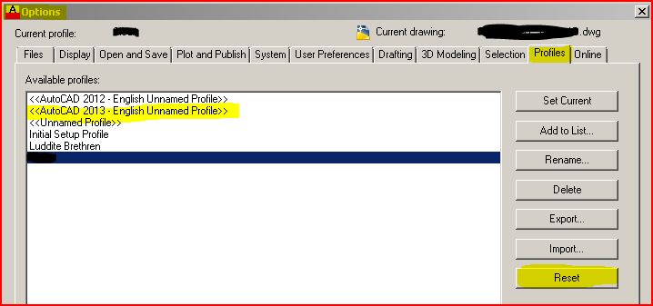

Dadgad Posted October 7, 2013 Posted October 7, 2013 Try switching to another user PROFILE, SET CURRENT, and report back, whether you still have the same problem after doing that. Quote
isutheparambil Posted October 7, 2013 Author Posted October 7, 2013 Pl. tell me the way how to do this..then i ll try.. i hope.. Quote
Dadgad Posted October 7, 2013 Posted October 7, 2013 (edited) OPTIONS, Enter, PROFILES tab at the right hand end of tabs in options. See what PROFILE is current, if available choose another PROFILE, then SET CURRENT, OK. This is not meant to imply that previous posts are incorrect, but something to consider, or investigate. If you have no other available PROFILES which you can set surrent? Try the RESET button. Edited October 7, 2013 by Dadgad Quote
isutheparambil Posted October 7, 2013 Author Posted October 7, 2013 Dear i tried that u mentioned way, no use..as before Quote
isutheparambil Posted October 7, 2013 Author Posted October 7, 2013 not working....i tried all... when i reset from option menu, it is problem. otherwise i can work present file...only... Quote
Dadgad Posted October 7, 2013 Posted October 7, 2013 I suspect that ReMark was on the right track then, sounds like a script or network issue, sorry I couldn't help you more. Quote
