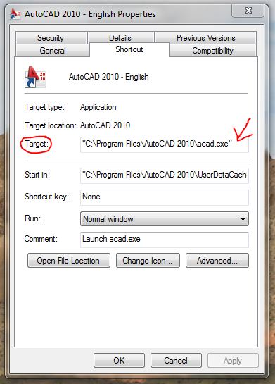

ReMark Posted October 7, 2013 Posted October 7, 2013 Did you know that you can run a script at the startup of AutoCAD? It is accomplished by adding the /b startup switch to the end of the information in the Target box found in the Properties window for your desktop AutoCAD shortcut. Is it possible this is what is happening on your system? Quote

ReMark Posted October 7, 2013 Posted October 7, 2013 how to create AutoCAD with a profile switch.. i got how to save a profile and how to run it on an opened Auto Cad..if like that way i can do this, if create a shortcut with a profile switch without open an autocad, thats my confuse. pl. explain me... To add a startup switch right click on your AutoCAD Shortcut then click on the Properties option. Startup switches are added at the end of the line in the Target box. To run a script file to after launching AutoCAD add the startup switch with a space and the name of your script file. In the following example the script name is mycustomsvfscript. "C:\Program Files\AutoCAD 2010\acad.exe" /b "C:\mycustomsvfscript" Quote
isutheparambil Posted October 8, 2013 Author Posted October 8, 2013 Hi, Its working, but only for first file, otherwise while open an other file from the cad menu, same as before..and also this is the only thing that created shotcut of auto cad only i applied this script from my c drive. i didnt try that on the master.( i mean admin application)..pl. let me know Quote
ReMark Posted October 8, 2013 Posted October 8, 2013 What's working? You were given two different suggestions. One was from RobDraw about creating a new profile. The other was from me about editing the AutoCAD shortcut. I would have tried Robdraw's suggestion first. The question is, did you do that or not? Quote
isutheparambil Posted October 8, 2013 Author Posted October 8, 2013 The Auto cad shortcut is working, but that is only can open the first file, that means the Drawing named file only without disturbance. on the first run i can see the script files r running on the command menu. then when i open a new drawing on the same Auto cad window, the drawing , with the variable problems. except the profile suggestion from you (Re Mark), all suggestions are working well, but only the thing thats all are for the first drawing only. this is the issue now i m facing. after repair, ie i applied that all possible chances, all that are for the first drawing only. what we can do for to open an other dwg in the same window, without any disturb... i hope u got me... Quote
