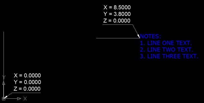

ReMark Posted October 21, 2013 Share Posted October 21, 2013 Here is what my Test.scr script file looks like. ;Test.scr ; This works. How do I know? I tested it before posting. -LAYER M Test c Blue ;You can add a comment anywhere as previously stated. Test -STYLE Lab_05-1 ;I don't think a style name can have a space if entered at the command line. Verdana 0.25 1 0 N N TEXT 8.5,3.8 0 NOTES: TEXT 1. LINE ONE TEXT. TEXT 2. LINE TWO TEXT. TEXT 3. LINE THREE TEXT. Quote Link to comment Share on other sites More sharing options...
ReMark Posted October 21, 2013 Share Posted October 21, 2013 Text started right where you specified. Quote Link to comment Share on other sites More sharing options...
