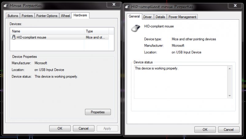

kArThIcK hAcKeR Posted November 14, 2013 Author Share Posted November 14, 2013 Have you checked your Windows mouse settings? see attachedscreen shot below yes, i checked it just now, i have 5 tabs in the mouse dialog box, 1. Buttons, 2. Pointers, 3. Pointer Options, 4. Wheel, 5. Hardware. and the hardware tab only displays the properties of the Mouse such as "Name", "Driver, Details, Power Management, Quote Link to comment Share on other sites More sharing options...
ReMark Posted November 14, 2013 Share Posted November 14, 2013 Wouldn't you want to be looking on the Wheel tab for either an AutoScroll option or an Advanced button then an AutoScroll option? I have a better idea. Forget using the mouse and enable the Scroll Bars in Options > Display and use them instead. Quote Link to comment Share on other sites More sharing options...

kArThIcK hAcKeR Posted December 18, 2013 Author Share Posted December 18, 2013 i found a way to switch off direct mouse wheel zooming (well, to be exact i found a command to pan up and down:oops:) i got into the CUI made a new shortcut for pan up as ctrl+up and pan down as ctrl+down. i used the "x button mouse control" software to remap normal wheel up to ctrl+up and wheel down as ctrl+down and my problem got solved. now the autocad scrolls like a pdf document. thanks for the help guys!!!! i wouldn't have gotten this idea without you guys:thumbsup: Quote Link to comment Share on other sites More sharing options...
