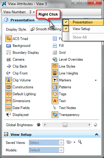

So...I am an AutoCAD guy, but we have a huge project coming up at work and we have to use Microstation so I'm trying to learn.
I was playing around with the program and pushing random buttons to see what they did (i know, probably not the greatest idea ever...:roll:) and somehow made the "presentation" group of the view attributes panel disappear. Also, I saved the settings without knowing that I had messed up my view attributes panel. Now, the only group that shows up in the view attributes panel is "view setup". For the life of me, I cannot figure out how to get it back!
Anyone have any ideas?

adrath, open the view attributes dialog and right click in the title. From the pop up menu you should be able to toggle the display back on.

Aha! Problem solved. Thanks, envisioncad!
