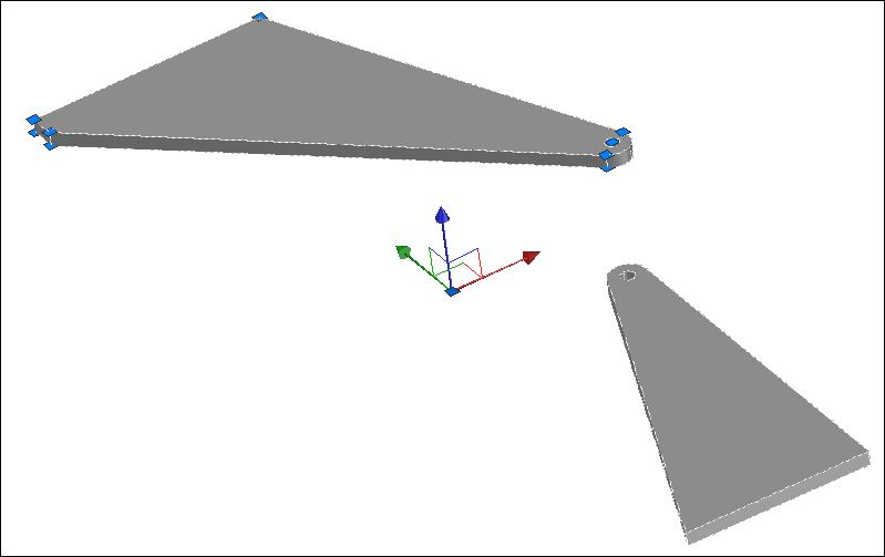

sofa Posted December 14, 2013 Share Posted December 14, 2013 When I select a solid I can never know where the grips will appear. I personally would like to have grips on the edges (vertex?) points and other geometrically interesting points (centers of arcs, circles..). Is there a way to get it Quote Link to comment Share on other sites More sharing options...

sofa Posted December 14, 2013 Author Share Posted December 14, 2013 I did, but than I get grips on individual elements that do not help manipulation of solid Quote Link to comment Share on other sites More sharing options...
ReMark Posted December 14, 2013 Share Posted December 14, 2013 Maybe if you attach an image of your solid we'll have a clearer picture of what you are attempting to edit via grips. Quote Link to comment Share on other sites More sharing options...
nestly Posted December 14, 2013 Share Posted December 14, 2013 ... or a sample drawing. Quote Link to comment Share on other sites More sharing options...
sofa Posted December 14, 2013 Author Share Posted December 14, 2013 I tried to import a picture but could not from my computer, only from URL. I did ATTACH the picture of my question. I am not sure how it is visible so I will add short explanation: I have two solids; first selected gives grips on all points whereas the other had only one grip. I drawed the two the same way??? I was trying to align those solids on the center line of the hole in them ( to move them to the same vertical line ) Quote Link to comment Share on other sites More sharing options...
ReMark Posted December 14, 2013 Share Posted December 14, 2013 Why not just use the ALIGN command? Quote Link to comment Share on other sites More sharing options...

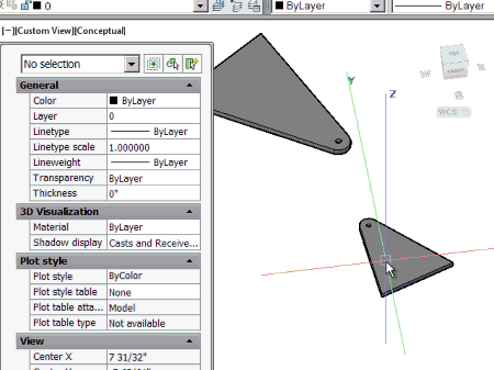

nestly Posted December 14, 2013 Share Posted December 14, 2013 That doesn't look like a screenshot from 2007, you should update your profile. Regarding grips, IMO you probably modified the part with only one grip, changing it's solid "type". As for moving/aligning, you don't need grips for those operations, only OSNAPS. Quote Link to comment Share on other sites More sharing options...
sofa Posted December 14, 2013 Author Share Posted December 14, 2013 You are quite right. When registering I made a mistake - I was using 2007 a while ago. Now it's 2013. Anyway: I expected a very straight or simple answer to my question: IS THERE A WAY I CAN DEFINE WHERE GRIPS WILL APPEAR???. A while ago I selected the same solids again and got again one grip on BOTH solids. WHY? I designed both solids by making a box and than slicing it! No way I used extrusion. I use ACAD only for my own needs and am very far from being qualified. For instance I cannot follow explanation of nestly (can't find 'geometry' in the properties, don't understand how snap to center of circle occurred...) Quote Link to comment Share on other sites More sharing options...
ReMark Posted December 14, 2013 Share Posted December 14, 2013 Attach a copy of the DWG file to your next post. Personally I'd use the ALIGN command. You do have Center set as one of your OSnaps don't you? Quote Link to comment Share on other sites More sharing options...
nestly Posted December 14, 2013 Share Posted December 14, 2013 Sorry about not giving a direct answer. To the best of my knowledge, there is no way to display grips at every corner (vertex) on a 3D solid object. At best, 3D "primitives" (box, cylinder, etc) will display multiple grips at the "base" and defining geometry, but even those wont have grips at each corner. I think when you modify a 3D primitive so it's no longer a "primitive" ie SLICE, then the solid will have only one grip. The "Geometry" section will only appear in Properties for unmodified 3D solids, ie before it's SLICEd With regards to "snaps", everything in AutoCAD becomes easier when using OSnaps, so I recommend familiarizing yourself with them at your first convenience. With OSnaps, you'll quickly learn how to move objects in AutoCAD to the exact location you want them. Here's a link to a OSnap tutorial here at Cadtutor, but you may be able to find similar tutorials in video form by searching Youtube. http://www.cadtutor.net/tutorials/autocad/object-snap.php BTW, to update your profile, click on the "My Profile" link at the top right of the page next to your username, then click the "About Me" tab. The little pencil in each field is the "edit" button. Quote Link to comment Share on other sites More sharing options...
