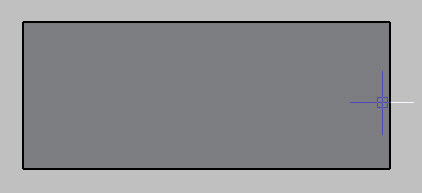

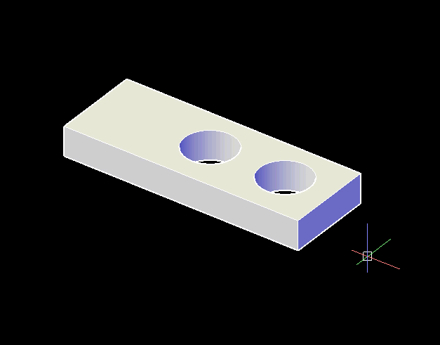

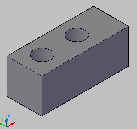

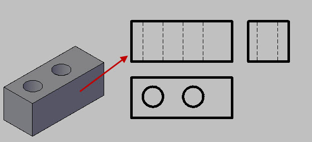

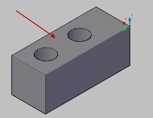

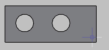

highflybird
This is a simple 3D solid
when use -view _front, Become like this
NOW,What I want is such a result
After running commands, and prompted to select a face
After confirmation, the surface will automatically rotate to the front
Use -view _front ,is this

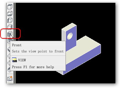

highflybird
Why I need this function ?
You have helped me to modified zsst.lsp,
The front view is main view,I want to change the main view to another surface5.jpg
Share this post
