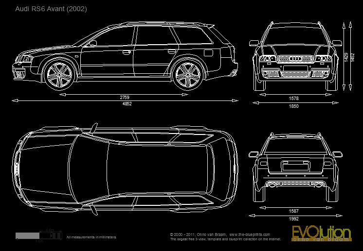

Bilbo Posted February 8, 2014 Author Posted February 8, 2014 well, apparently not. ugh I'm screwed... http://www.the-blueprints.com/vectordrawings/show/5070/audi_rs6_avant/ I just bought some "credits" and downloaded the DWG, DXF and EPS formats and none of them opened or imported successfully to R12. Quote
ReMark Posted February 8, 2014 Posted February 8, 2014 Don't give up just yet. If you download DWG Trueview you can open the DWG files and then save them in a format you can open. Quote
Bilbo Posted February 8, 2014 Author Posted February 8, 2014 does this file open for you? hmmm, uploading the DXF even fails here on the upload manger... Audi RS6 Avant (2002).dwg Quote
ReMark Posted February 8, 2014 Posted February 8, 2014 Give me a moment to fire up my CAD computer. I did mention an option available to you in my previous post. Yes, I can open the drawing. AutoCAD informs me the drawing was not originally done using an AutoDesk product. I have it open on my CAD computer as I type. Quote
ReMark Posted February 8, 2014 Posted February 8, 2014 This is what I see after turning off a layer named Solids. Quote

ReMark Posted February 8, 2014 Posted February 8, 2014 Yeah, I hear a lot of wind in here too. Must be a southeaster from PA. Bilbo: I saved the file in r12 DXF file format but it weights in at a whooping 43.8MBs. Quote
