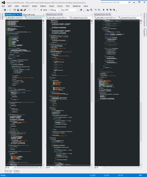

alanjt Posted March 5, 2014 Share Posted March 5, 2014 I've been messing with it for a while but I guess my understanding of lisp is still to rudimentary. Is it possible to have the background toggle colors at the same time as your command is entered? If I have to stick with two separate lisps, then no big deal. But that would be the icing on the lisp cake. Tanks, -Nobull Actually, what would be pretty slick, would be to create a reactor that would change all settings based on when the viewport is/not activated. Activated: plot styles off, black background, lineweights off, etc. Deactivate: plot styles on, white background, lineweights on. Wouldn't be that hard to do, and most of the coding has already been done. Might have to do this for myself. I suddenly like this idea. Quote Link to comment Share on other sites More sharing options...
Nobull84 Posted March 5, 2014 Author Share Posted March 5, 2014 Actually, what would be pretty slick, would be to create a reactor that would change all settings based on when the viewport is/not activated. Activated: plot styles off, black background, lineweights off, etc. Deactivate: plot styles on, white background, lineweights on. Wouldn't be that hard to do, and most of the coding has already been done. Might have to do this for myself. I suddenly like this idea. I like that idea as well. Hopefully, we can come up with both here maybe? The entire idea behind all this is that we are going paperless, more sooner than later. We have now two 19" monitors and one 42" monitor to replace paper sheets. I am one of the two testers for this and we are moving forward with this. I do notice though that some mistakes are more easily caught after being plotted on paper. I am trying to simulate this print without having to actually plot to the PDF program. That transfer from CAD to the PDF viewer sometimes just takes too long. Any help appreciated as always, -Nobull Quote Link to comment Share on other sites More sharing options...
tzframpton Posted March 5, 2014 Share Posted March 5, 2014 Wouldn't be that hard to do, and most of the coding has already been done. Might have to do this for myself. I suddenly like this idea.I would be highly interested in this as well. My tutorial works good for "me" but not in a collaborative environment with other drafters. If you do develop something I would most certainly be a beneficiary to this customization, as would lots of people I think. Quote Link to comment Share on other sites More sharing options...
alanjt Posted March 5, 2014 Share Posted March 5, 2014 I would be highly interested in this as well. My tutorial works good for "me" but not in a collaborative environment with other drafters. If you do develop something I would most certainly be a beneficiary to this customization, as would lots of people I think. The more I think about it, the more I like the idea. I'll work on something in a bit. Quote Link to comment Share on other sites More sharing options...
BlackBox Posted March 5, 2014 Share Posted March 5, 2014 I would be highly interested in this as well. My tutorial works good for "me" but not in a collaborative environment with other drafters. If you do develop something I would most certainly be a beneficiary to this customization, as would lots of people I think. The more I think about it, the more I like the idea. I'll work on something in a bit. Implementing the code logic, such that the event handler hooks any save to the database, or destruction of the document (where changes are saved), in order to first restore 'correct' settings is the easy part, and can be done with Visual LISP without issue. So too, is it easy to implement a means by which a user can specify persistent settings which predetermine the user's default settings for each-and-every-single setting change, and to also store the 'restored' values prior to save/close if one wants to always have specific setting values when opening a given drawing. It is a great deal harder to account for other code that may or may not change a setting, or LayerTableRecord while this app is enabled, especially for users that aren't yet proficient enough to code this app themselves... But still possible. Some may not appreciate my having done so (and that's perfectly fine), but that's why I went to the extent I did in the other thread... To try and make this app something that many users, and employers could actually use for their daily work, in the real world, on real projects... Both internally, and when sharing drawings externally. FWIW - I've already coded most of this app in .NET API (each window zoomed out to 26% for clarity): Code snippet from my .NET plug-in: // (C) Copyright 2013 by BlackBoxCAD.com // using Autodesk.AutoCAD.ApplicationServices; using Autodesk.AutoCAD.DatabaseServices; using Autodesk.AutoCAD.Geometry; using Autodesk.AutoCAD.EditorInput; using Autodesk.AutoCAD.Internal; using Autodesk.AutoCAD.Runtime; using Autodesk.AutoCAD.Windows.Data; using acApp = Autodesk.AutoCAD.ApplicationServices.Application; using System; using System.Collections.Generic; using System.Collections.Specialized; using System.ComponentModel; using System.Reflection; [assembly: ExtensionApplication(typeof(BlackBox.AutoCAD.LivePlotPreview.Monitor))] namespace BlackBox.AutoCAD.LivePlotPreview { class Monitor : IExtensionApplication { //private bool layerTableIsWatched; //private bool layerTableHasChanged; //private bool reconcileNeeded; private bool layerCommandIsActive; private bool layersChanged; private bool layoutSwitching; private DataItemCollection layers; private DocumentCollection acDocs; private int fieldDisplay; private int layLockFadeCtl; private int lwDisplay; private int pdmode; private int xDwgFadeCtl; private ObjectIdCollection layerIdsNotPlottable; private ObjectIdCollection layerIdsPlottable; private string newLayout; void IExtensionApplication.Initialize() { acApp.SystemVariableChanged += onSystemVariableChanged; acApp.DocumentManager.DocumentCreated += onDocumentCreated; acApp.DocumentManager.DocumentToBeDestroyed += onDocumentToBeDestroyed; acDocs = acApp.DocumentManager; //Setup(acApp.DocumentManager.MdiActiveDocument); WatchLayers(); } void IExtensionApplication.Terminate() { } [CommandMethod("FOO")] void FOO() { Document doc = Application.DocumentManager.MdiActiveDocument; Editor ed = doc.Editor; PromptSelectionResult psr = ed.GetSelection(); if (psr.Status == PromptStatus.OK) { List<string> layers = new List<string>(); ObjectId[] ids = psr.Value.GetObjectIds(); using (Transaction tr = doc.Database.TransactionManager.StartOpenCloseTransaction()) { foreach (ObjectId id in ids) { Entity ent = (Entity)tr.GetObject(id, OpenMode.ForRead); string layerName = ent.Layer; if (!layers.Contains(layerName)) { layers.Add(layerName); } } int i = layers.Count; ed.WriteMessage( "\nYou selected {0}:", i, i == 1 ? "this layer" : "these layers"); layers.Sort(); foreach (string layerName in layers) { ed.WriteMessage("\n{0}", layerName); } ed.WriteMessage("\n"); tr.Commit(); } } } int GetVar(string var) { return Convert.ToInt32(acApp.GetSystemVariable(var)); } void onCollectionChanged(object sender, NotifyCollectionChangedEventArgs e) { if (SwitchingToLayout() && e.Action == NotifyCollectionChangedAction.Add && e.NewStartingIndex == -1) { if (layersChanged) { //UpdateLayers(); UpdateViewports(); } else { layersChanged = true; } } } void onCollectionItemsChanged(object sender, NotifyCollectionItemsChangedEventArgs e) { if (layersChanged) { //UpdateLayers(); UpdateViewports(); } else { layersChanged = true; if (!layerCommandIsActive) { //UpdateLayers(); UpdateViewports(); } } } void onCommandEnded(object sender, CommandEventArgs e) { Document doc = acDocs.MdiActiveDocument; doc.CommandCancelled -= onCommandEnded; doc.CommandEnded -= onCommandEnded; doc.CommandFailed -= onCommandEnded; layers.CollectionChanged += onCollectionChanged; layers.ItemsChanged += onCollectionItemsChanged; doc.Editor.WriteMessage( "\n[LivePlotPreview] : onCommandEnded({0}) \n", e.GlobalCommandName.ToUpper()); if (layersChanged) { //UpdateLayers(); UpdateViewports(); } else { layersChanged = true; } layerCommandIsActive = false; } // ... } } ... As of 2013-11-09, I'm at a stopping point with certain API features not yet being exposed to even .NET API according to my friends at ADN that review, and have published my Exchange Apps. Specifically, the ability to properly handle any *Layer* change(s) from both Command calls, Layer Manager, and other code (such as Scripts, Macros, LISP, etc.) made while this app is enabled, and subsequently correctly account for which VPLayers are VPFrozen, VPThawed, etc. within each-and-every-single PViewport, on each-and-every-single Layout. Even if only accounting for a single Layout, and it's subsequent multiple PViewports, it is quite the challenge given the API feature relegation, and I've tried monitoring Application Events, Collection Events, Command Events, Document Events, Layout Events, Point Filter Events, System Variable Events, and even the UIBinding.Collection only to reach 'close' to what I was after. [Edit] - ... And ADN staff informing me that this isn't yet possible, and they're paid to tell me the truth (thank you ADN membership). ... This really is a great idea, and I'm very anxious myself to contribute to it's successful release, if you couldn't tell by the +/-550 lines of C# pictured above. Unfortunately, it appears that this app shall fail to properly account for all potentialities until Autodesk exposed the complete roster of API features specifically, and implicitly required (and those are just the one's I've identified to-date; there may be others I am currently unaware of). Quote Link to comment Share on other sites More sharing options...
