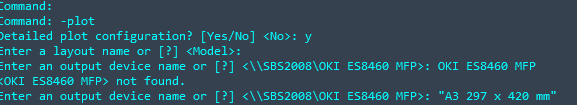

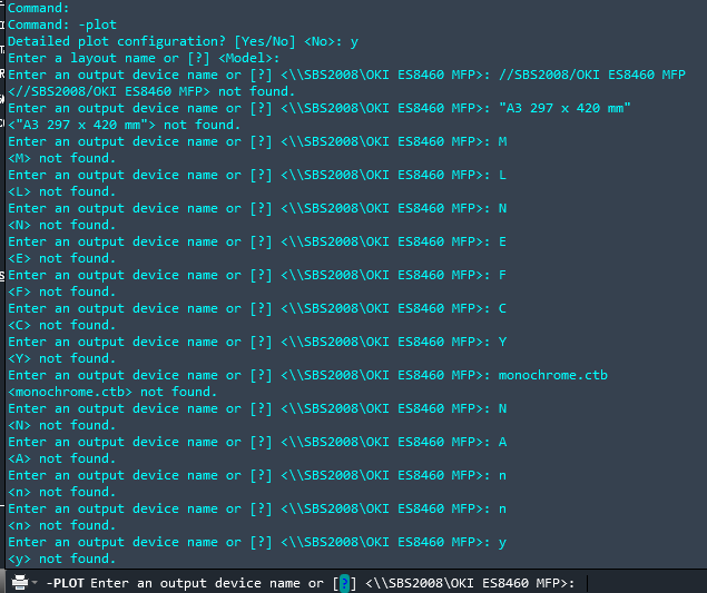

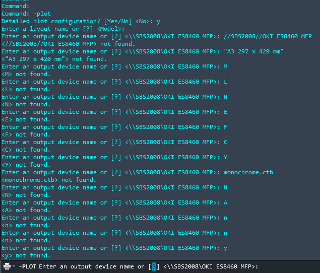

Barneel Posted April 28, 2014 Author Share Posted April 28, 2014 Hi, Thanks for all your replies. I have just had a go at everything mentioned here, as well as combinations of them. It still seems to be getting stuck on this step however. I'm fairly certain I have plotter name correct - selecting "?" on: "-Plot, Enter an output device name or [?]" provides a list of plot devices, and lists my printer as "\\SBS2008\OKI ES8460 MFP" If there is another way to check if this is correct please let me know! You are correct in saying backslashes make it pause for user input - I didn't know this. However replacing them with forwardslashes doesn't fix it. Attached is a screencap of F2, showing it is able to record the entire printer name (because it tells me /SBS2008//OKI ES8460 MFP> was not found), but is not able to use it. (Also, I'm aware I could just leave this step blank and let it select it as the default plotting device, but it won't always be the case that it is the default). Any further tips as to where I might be going wrong? I really appreciate all your help so far! Quote Link to comment Share on other sites More sharing options...
dbroada Posted April 28, 2014 Share Posted April 28, 2014 (edited) I think you have too many \ in your first line. Its telling you the default (\\SBS2008\OKI etc.) but you have supplied //SBS2008//OKI etc. This is my button code... ^C^C-PLOT;Y;Layout1;EUGBHORPD026;A3 (297 x 420 mm);M;L;N;E;F;0,0;Y;STL Mono.ctb;Y;N;N;N;N;N;Y As you have seen, scripts just continue so if you get one bit wrong it continues until it gets an answer that fits - sometimes with bad results. I have just realised that that one looks for a .pc3 file so doesn't need the path to the printer. In my script files the line that calls the printer is "\\eugbhorfile003\EUGBHORPD026" Edited April 28, 2014 by dbroada didn't read my post well enough Quote Link to comment Share on other sites More sharing options...
Barneel Posted April 28, 2014 Author Share Posted April 28, 2014 Well spotted. Unfortunately that still hasn't fixed it. Also tried it without the path: And without spaces without the path: Quote Link to comment Share on other sites More sharing options...
