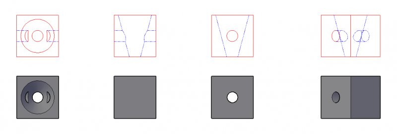

Rotate your 3D model first then run Flatshot. Repeat as many times as required.
Or...make copies of your 3D model, rotate them accordingly then run Flatshot once.
Edited by ReMark
One shot Flatshot using copies of the original 3D model.
Top row = Flatshot results.
Bottom row = 3D models.

It doesn't matter if I looked at it or not. The techniques I've suggested should work for any view.
If you can't get it to work then skip Flatshot and use BaseView. AutoCAD will automatically figure it out for you. Use the right tool for the job at hand.

I have just got the rotation angle right. Thanks very much for the help
