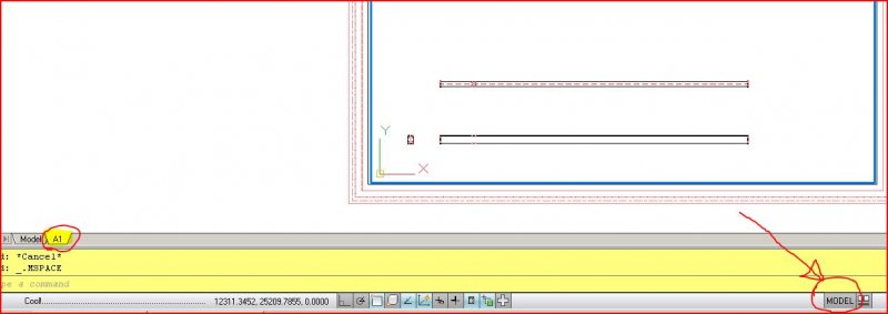

curtie20 Posted May 15, 2014 Author Posted May 15, 2014 Hi Guys I am faced with another problem. I have created a 2D object from a 3d object using flatshot. I have created 2 viewports to show the 2d object in the one viewpoint and to show the 3D object in the other viewport in model space. The problem I'm having is both the 2D and 3D object are showing in both the viewports. When I try to edit the drawing in the one viewpoint to delete. It edits in both viewports Quote
Dadgad Posted May 15, 2014 Posted May 15, 2014 It sounds like you are on your LAYOUT TAB, but that you have double clicked inside of one of the viewports, which means you are actually in MODELSPACE. If you look at the bottom of your screen, over towards the right, does it say MODEL or PAPER. Look at the attached image. While it appears I am in Paperspace, you can see at the bottom MODEL is showing, and the viewport is HIGHLIGHTED. In this situation, anything you do will be displayed in all viewports. What you need to do is to click ONCE ONLY inside whichever viewport you are trying to set up, make sure that it is unlocked, so that you can position the view within the viewport, and scale it however you want. Once you are happy with it, LOCK the viewport scale. Then you should repeat the process in your second viewport, setting up the view however you want it, and once again LOCKING the viewport scale when you are finished. Quote

Dadgad Posted May 15, 2014 Posted May 15, 2014 It sounds to me like you want to be setting up PAPERSPACE viewports, not Modelspace VIEWPORTS. A viewport created in MODELSPACE will show everything in your MODEL, and anything you do in one, will also happen in the other, although likely from a different perspective. Late to the party. Having just reviewed your assignment, I see that you have been asked to create the viewports in a LAYOUT or in MODELSPACE, so you may go either way. If both objects are showing up, move them further apart, then zoom to focus on the different items in your two viewports. Quote

Dadgad Posted May 15, 2014 Posted May 15, 2014 As I suggested earlier, your objects are so close together that it makes it a bit difficult to isolate them in your different views. Move them further apart, so as to facilitate displaying each of them independently in their own viewports. Come to think of it you could display them independently by just zooming into each of the viewports and adjusting your view a bit, so that the other object didn't show. Just click into the viewport you want to adjust to make it active, then hold down your MOUSE WHEEL and you will be able to grip and drag to set up your view. Quote
