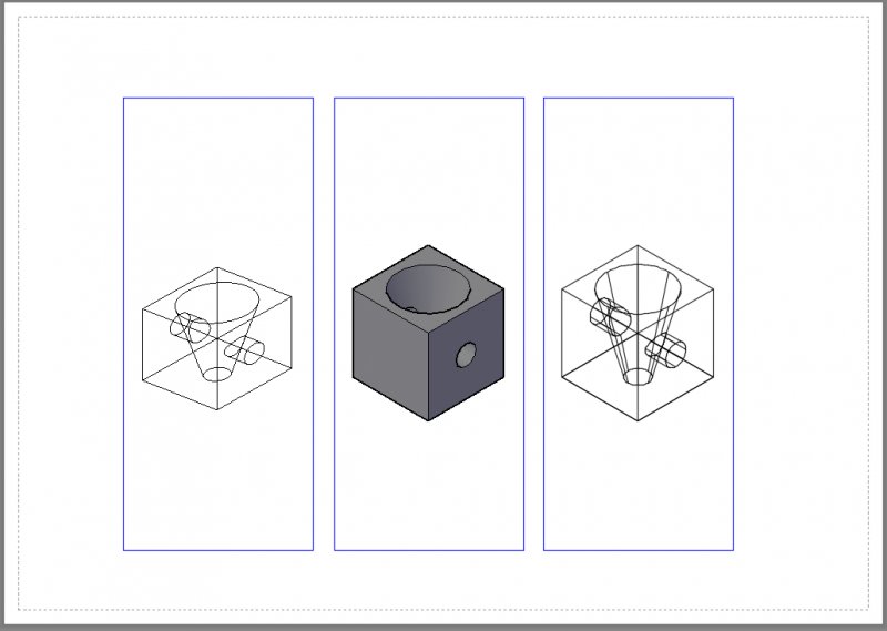

ReMark Posted May 15, 2014 Posted May 15, 2014 If you read the link I posted previously (see post #41) regarding viewports you would understand there are two types: model viewports (a.k.a. - tiled) and layout viewports (a.k.a. - floating). You should be using the MVIEW command in your paper space layout to create a viewport for each object. F.Y.I. - Within the thread the first link takes you to is another link regarding viewport scaling. It too is worth reading as well. Quote
ReMark Posted May 15, 2014 Posted May 15, 2014 Paper space layout with three viewports. Did you know each viewport can have its own visual style? Quote

ReMark Posted May 16, 2014 Posted May 16, 2014 You aren't all the way there yet but you have made progress. I would recommend setting the viewport scales to 1:8 then I would lock the viewport displays so the scale cannot be accidentally changed. The red lines in the 2D representation should appear dashed should they not? Your viewports should be on their own layer set to "no print" in the Layer Properties Manager. Quote

ReMark Posted May 16, 2014 Posted May 16, 2014 Getting closer. Ideally viewports should be on their own layer (not layer 0) and their display locked. Anyone, including yourself, could try working through a viewport and inadvertently change the scale. The viewport layer can be set to "no print" (i.e. - red diagonal line through printer icon) in the Layer Properties Manager. All this was covered in the link I previously provided and mentioned more than once. Quote

ReMark Posted May 16, 2014 Posted May 16, 2014 You locked the layers; you did not lock the viewport display. There is a difference. One of the places this option can be found is on the Properties palette. Did you not see/click on/read the link in the viewports article I wrote? I think I'll have to start leaving a trail of breadcrumbs for people to follow. Quote
ReMark Posted May 16, 2014 Posted May 16, 2014 1. It looks like both viewports are on layer 0. 2. Your 2D view created with the Flatshot command is not quite right. It is somewhat distorted. This is primarily due to the location/rotation of your UCS when you used the command. Quote
rkent Posted May 16, 2014 Posted May 16, 2014 I think I got it right now Your view of the flatshot objects is skewed, giving a shortened view. Prior to using flatshot Set an iso view like SW Set UCS to World run flatshot... To see the flatshot objects change to a top view In PaperSpace, create the viewport, change to a top view if it isn't already there, adjust view and scale, etc. My Project.dwg Quote

ReMark Posted May 16, 2014 Posted May 16, 2014 I accessed the Display Locked option using another method (highlight/right-click on viewport frame(s). Note the difference between my 2D view created using the Flatshot command and yours. Doesn't mine look closer to the overall shape of the 3D model? That's why, early on, I said you would be better off using the ViewBase command rather than Flatshot. ViewBase will give you better, more predictable, results on the first attempt than Flatshot will. Quote
