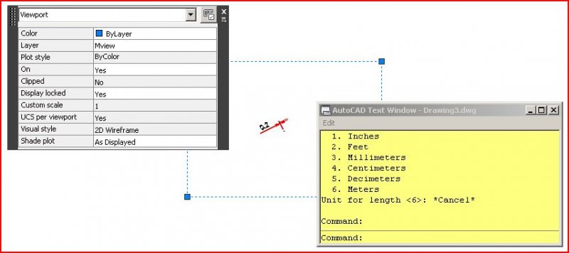

Actually it's just the standard acadiso.dwt template file with a .2 unit long line drawn in modelspace. I'm just trying to understand why a 1:1 viewport in paperspace won't recognize meters as the drawing units.
It will, see the screenshot.
Set your -dwgunits value before you draw the line to 6 for meters, and give it another try.

It's because the line was originally drawn at 2 mm. This is what happens.
Change units to meters using -dwgunits >> Units are changed to meters, and since the line was drawn at 2 units, it remains 2 units long.
Automatically scale objects to the new units >> The line once again becomes 2 mm long because Autocad thinks you want it to be how you originally drew it, which is 2 mm.
It was scaled back to it's original size because that is what the Automatic scale function is intended to do.
You have to scale your line back up to 2 meters, factor = 1000, or redraw it at 2 units long.
If you had drawn a car at 4 units long, and then discovered you were working in mm instead of the intended meters, you certainly would want your car to be 4000 mm (4 m) long instead of 4 mm, so the Automatic scale step should have been answered with a No.

I suspect you may be confusing Plot Scale with Viewport scale. Plot scale is (almost) always 1:1 (in other words, one letter size paper = one letter size paper) unless you have to force your layout onto a different size paper temporarily.
In paperspace, you can only choose mm or inches for paperspace units since even that largest commonly used paper is less than a meter long.
In the viewport, you set your scale to what you need, not in the page layout. Select the viewport. Open Properties. Unlock Display, change the Annotation scale and the Standard Scale to the scale you wish to use, even if you are not using annotative dimensions. The standard Scale may change automatically when the annotative scale is changed.
Let's see, 0.2 meters is 200 millimeters. That should fit a letter size plot at 1:1 and go about 80% of the way across the paper.
