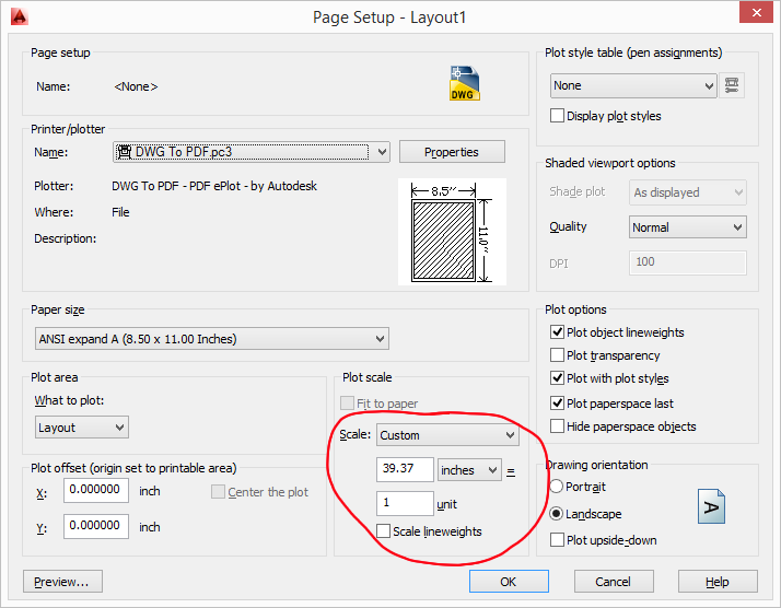

SEANT Posted June 1, 2014 Posted June 1, 2014 I think the problem is that the AutoCAD drawing editor doesn't know anything but units. Everything else needs to be calibrated. So, the scale needs to be input during the page setup as well. See Image and associated drawing file. metersForPrint.dwg Quote
dan_m Posted June 1, 2014 Author Posted June 1, 2014 Setting 1000mm paper units = 1 model unit makes the line draw correctly in a 1:1 viewport...that problem is fixed (and makes sense). The viewport window blows up x1000 the size in the process but you just have to bring it back to size. How (annotative) dimensions and text look like is a different matter though, there doesn't seem to be a magic bullet setting that fixes everything at once. It looks like text sizes, arrow sizes, offsets etc... all have to be divided through by 1000 (ie a 2.5 setting becomes .0025) and to change that .2 to print as 200mm requires a little work there as well. You know what, I'll just keep drawing in mms and inches and learn to live with it.......... Quote

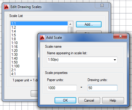

CADTutor Posted June 2, 2014 Posted June 2, 2014 I work in metres in model space most of the time and of course paperspace remains in millimetres. What I do is leave units set as is in the acadiso template but add a standard set of custom scales that can be used to scale the viewports. The default scales only work if modelspace and paperspace use the same units (essentially, if modelspace is in millimetres) and so a second set of custom scales is needed when the drawing is in metres. This is potentially confusing but I make sure the name of the new scale indicates which units it is for (m): Obviously, this scale could be expressed as 20:1 but 1000:50 makes it easier to see what's going on. With a set of these custom scales in your template, you don't need to worry about units when plotting. You'll still need to declare insert units if you're using blocks and xrefs but you'd need to do that anyway. Quote
