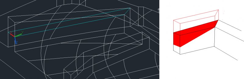

guitarpirate Posted June 7, 2014 Author Share Posted June 7, 2014 I started working on another part and I have the same problem, so maybe it's a good time to break that down. Let's say I have a ridge and I want to taper it somewhat on Z axis, from beginning of that ridge "section" to the end. The "max taper" would be current ridge height and "min taper" would be a specific measure on Z axis which is less than ridge height. I try to handle this by first drawing a line up on Z axis from the bottom of ridge's tip to top (midpoint to midpoint), following the surface. I make this line of specific height to measure the "min" taper on the end of the ridge. Then I draw a line in the flat area of the bottom and move it by midpoint to the end of the measuring line. This creates the first cut line on the face of ridge's tip. Then I draw another line exactly outlining the start of point of the ridge at the very top, where "max" taper is equal to ridge's current height. Then I draw two lines on each side. I join all the lines except temp measuring line into 3d poly and try to extrude, which usually doesn't work (creates 4 surfaces instead of a solid, which cannot be used for the boolean I need). To troubleshoot, I set UCS to follow the cut surface, switch to top view of new UCS and use FLATTEN command to flatten all polyline verts to the same plane. This moves one of the verts and AC doesn't let me move it back. Now the 3d polyline can be extruded and subtracted from the ridge, but creates extra geometry. I attached a step by step illustration. My guess is this is extra labor-intensive or plain wrong method to do this, so any tips are appreciated! (TYPO: in step #3, description should read "midpoint of horizontal line to endpoint of vertical line") Quote Link to comment Share on other sites More sharing options...
guitarpirate Posted June 7, 2014 Author Share Posted June 7, 2014 Well I realized something I haven't used yet... Solid features (verts, edges and faces) are editable by Ctrl+Clicking on a feature, so it's possible to taper a ridge by dragging on top edge of the tip, and move down by X units. That makes stuff much less complicated. In certain cases like making a little pyramid on top of a cross, I bet I could use Imprint to create edges on the top plane and then simply drag the pyramid top vert up to create a pyramid shape. Quote Link to comment Share on other sites More sharing options...

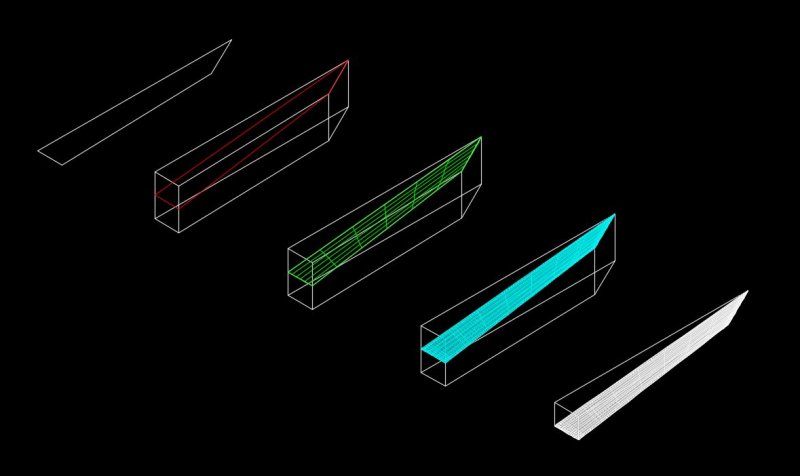

ReMark Posted June 7, 2014 Share Posted June 7, 2014 Is this kind of what you are looking to do? Quote Link to comment Share on other sites More sharing options...
ReMark Posted June 7, 2014 Share Posted June 7, 2014 From right to left. -Basic shape -Extruded shape with lines (red) -Mesh (green) created with Edgesurf command -Mesh converted to surface (cyan) -2Dwireframe of finished shape I'm sure that JDM can knock off a step or two. Quote Link to comment Share on other sites More sharing options...

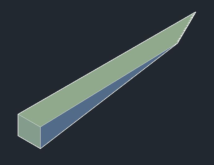

ReMark Posted June 7, 2014 Share Posted June 7, 2014 My version of the piece you are having a problem with. It is only roughly based on your geometry and shown here for demonstration purposes. Basically I created the base profile, extruded it, then sliced it with an inclined surface that was revolved around the part's center point. I think I stole the technique from a tutorial JDM did. If so the credit really belongs to him. Quote Link to comment Share on other sites More sharing options...

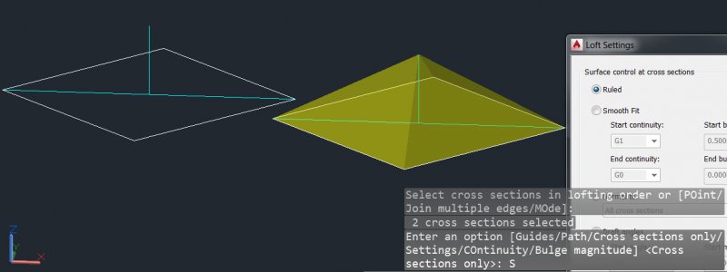

guitarpirate Posted June 7, 2014 Author Share Posted June 7, 2014 [EDIT - responding to your first post] So the edgesurf worked and the Mesh conversion worked, but I don't understand what you did to make the bottom disappear in the last picture. Extrude doesn't work on that surface, it extrudes every single facet separately using its edges. Thanks for the help, I appreciate you spending the time! Regarding the yellow cross piece, I want a 4-sided pyramid at the top. Revolving a shape (correct me if I'm wrong) will create a smooth dome so the pyramid ribs won't be visible. Quote Link to comment Share on other sites More sharing options...
JD Mather Posted June 7, 2014 Share Posted June 7, 2014 I use JZip. It's free and can unzip many file formats. If you're interested: http://www.jzip.com/ Thanks, but no thanks. I keep my personal computer super clean and never experience the problems others report in desperation. I have a test machine at work that I use for stuff like this. Unfortunately I don't get into the office much between May and August. Quote Link to comment Share on other sites More sharing options...
JD Mather Posted June 7, 2014 Share Posted June 7, 2014 I want a 4-sided pyramid at the top. Loft a square (or other desired base shape) to a point. (actually the other way around, the POint to the polygon) I exaggerated the height for illustrative purposes. I don't see any special geometry in your images (but then, I haven't looked at the dwg file). Only planar and cylindrical faces, as basic as it gets. Quote Link to comment Share on other sites More sharing options...

ReMark Posted June 8, 2014 Share Posted June 8, 2014 So the edgesurf worked and the Mesh conversion worked, but I don't understand what you did to make the bottom disappear in the last picture. To achieve the end result I removed the bottom of the object using the SLICE command with the SURFACE option. The SURFACE option allows the user to specify which side to retain (or both). The opposite side is automatically deleted. Extrude doesn't work on that surface, it extrudes every single facet separately using its edges. EXTRUDE is not the solution to every problem one faces when creating a 3D model. Open yourself up to other solid editing tools. Thanks for the help, I appreciate you spending the time! You're welcomed. It did not involve much time at all. Regarding the yellow cross piece, I want a 4-sided pyramid at the top. Revolving a shape (correct me if I'm wrong) will create a smooth dome so the pyramid ribs won't be visible. I am not at my CAD computer right now but just because you don't see any pyramid-like lines doesn't mean the piece I created is incorrect. Besides which, having that pyramid does not appear to have any worthwhile design function that I can see. Quote Link to comment Share on other sites More sharing options...
guitarpirate Posted June 8, 2014 Author Share Posted June 8, 2014 The slice/surf method totally works, great addition to my toolbox - thanks a lot ReMark! After staring at this geometry and feeling helpless for days, that gave me a nerdrenaline rush I don't know yet how well that will work with the cross shapes, I might have to slice off each branch of the cross before applying and then boolean them again. Worked perfectly with the ridge though, and I ended up going with a stright cut to maintain the surfaces perpendicular to each other on X/Y (SEANT: yes I did prefer them to be straight facing, although after experimenting with slicing I realized what I wanted originally could not be done with straight-facing planes). JDM: your method for creating pyramid worked fine on dummy geometry, I don't think I will have a problem there. I still have an earlier iteration of the bent part in post #1, so I will try to restart from that iteration and find a way not to introduce the artifacts. Thanks for your help, if after doing this I am still stuck I will upload the .zip to my website FTP and post a link. SEANT: I didn't realize the cross shape on the bent piece was not symmetrical, as I created one branch of the cross, copied 3 more times and rotated each 90 degree multiplies, then joined together. Perhaps lack of symmetry contributed to bad geometry here. I will re-create this part. Quote Link to comment Share on other sites More sharing options...
