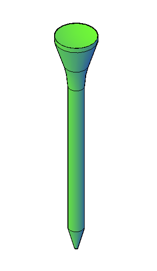

A golf tee can be modeled in 3D by creating a half profile then revolving it. Don't forget the top of the tee is slightly concave.
A rudimentary tee done in plain AutoCAD. The head is slightly concave although it may be difficult to tell from the image.
Visual style=Conceptual.

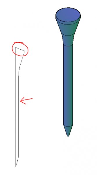

The closed profile, consisiting of a single continuous polyline, on the left is what I used to create the tee. An arc was used to create the concave top as JD Mather rightly suggested. The end result is a 3D solid. Should you use plain lines to create your profile the end result will be a surface.

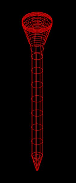

The tee as a set of revolved surfaces.
Visual style=2Dwireframe.

The free version of Draftsight is 2D only.
[ATTACH=CONFIG]49496[/ATTACH]
I should think one might have a pretty hard time nesting a ball into the point on the top of this revolved object? Unless of course one is teeing up a marshmallow, or something has changed quite drastically in golf since I last humiliated myself on the links. :|
Link to post
Critics...a dime a dozen. It was merely an exercise. Feel free to post a dimensionally correct version with golf ball. Please include the dimples on the ball too for the sake of realism. Oh, and the manufacturer's name and logo. Thank you.

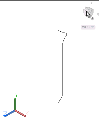

What point? Looks fine to me?
Link to post
Also looks fine to me... I think Dadgad just didn't notice the perspective.
[ATTACH=CONFIG]49521[/ATTACH]
nestly, you are absolutely right on the mark, and your video displays brilliantly my misperception.
Given the absence of any UCS icon reference, I erroneously assumed a Plan view.
Glancing at it, it confused me, for that reason, and I already knew how to model it.
I figured that if it confused me, there was a better than even chance the op would also be confused.
Sorry ReMark, it certainly didn't seem like you to just throw something down, and have it be conspicuously
bass akwards. Mea culpa, mea maxima culpa! :beer:
