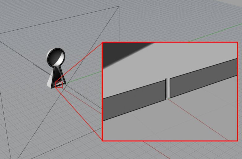

Rhino has a surface focus. Thus, some of the concepts that pertain to "Solids" in other software applications are not present in Rhino. One such concept is internal hollows - or, put another way - surfaces/surface incorporation without direct connection.
The typical way to deal with this is to add a direct connection. See attached image. I was able to hollow out that figure by providing a minimal direct connection in an inconspicuous spot.
thank you very much, I already solved the problem with the same tecnique but in a different way ^^
