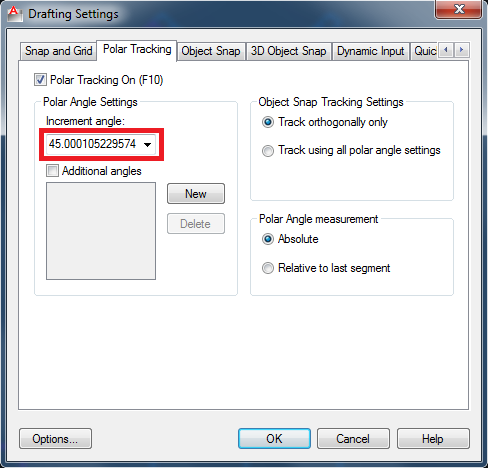

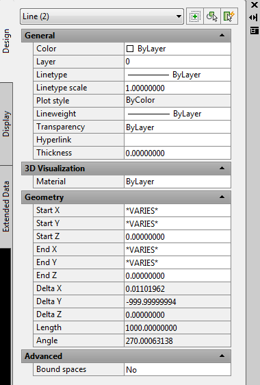

SAFeSTeR Posted August 7, 2014 Share Posted August 7, 2014 (edited) Hi, I've always used polar tracking instead of ortho mode where possible, but just recently I've noticed that it seems to be a bit 'off' when drawing verticle lines. I first noticed this issue a few days ago when I offset a horizontal line but the extreme right verticle line would not trim. When I zoomed right in, the lines were not touching. I made a few tests by drawing 6 verticle lines, 2 each at 1000, 2000 and 3000 units in length, using polar tracking of course. I looked at the co-ordinates of all the lines vertices and the X values did not match, indicating a diagonal line, albeit very slight. However, when I compared these X values I noticed that for every 1000 units the difference was between the vertices increased by 0.11 units, which seemed a bit uniform and something was at fault for these fluctuations. I also drew some lines with ortho mode activated and the lines were perfectly straight. Has anyone else experienced this or have any ideas as to why this may occur? Is there a 'fix' or some things I can check? Could it be a bug (although this has never happened to me until recently)? I know the difference is negligible, but at the same time it's bugging me a little bit. Thanks in advance. Edited August 8, 2014 by SAFeSTeR Problem solved Quote Link to comment Share on other sites More sharing options...

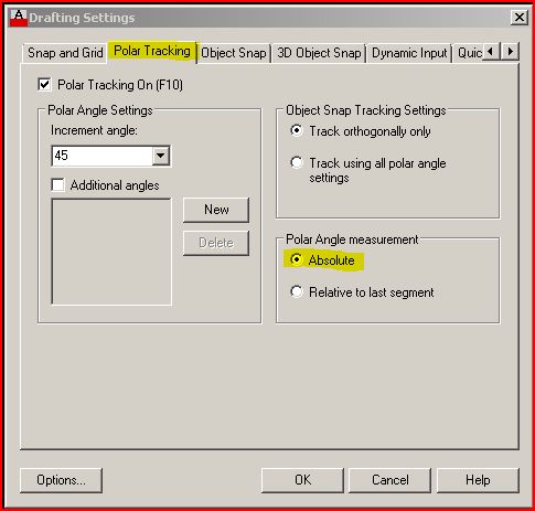

SEANT Posted August 8, 2014 Share Posted August 8, 2014 . . . . but if I try using the base of one of your polylines as the starting point it is also drawn wonky Is your Polar Angle measurement option set to 'Relative to last segment'? Quote Link to comment Share on other sites More sharing options...
Dadgad Posted August 8, 2014 Share Posted August 8, 2014 Have you looked at the Polar Tracking tab, to make sure it is set to Absolute, instead of Relative? Whoops, SEANT has visited while I was checking your drawing out! Quote Link to comment Share on other sites More sharing options...
RobDraw Posted August 8, 2014 Share Posted August 8, 2014 I think I've figured out what is happening. The polylines are not parallel to the Y axis. They are off by .00063138. Each pair is equal in length and parallel to all the other lines. I think if your tracking is set to "Relative to last segment", you will get what you have here. The problem is in the initial polyline. If it were drawn parallel to the Y axis, the subsequent lines would give you the expected result. Quote Link to comment Share on other sites More sharing options...
SAFeSTeR Posted August 8, 2014 Author Share Posted August 8, 2014 Thanks SEANT and Dadgad. While you were posting your image I was already looking into SEANT's advice and discovered the problem. Although it was found where you both suggested, it was not related to either 'Absolute' or 'Relative to last segment'. It was in fact something to do with the Increment Angle not being set to a whole number (see image). Don't ask me how this got changed Thanks all for your help Quote Link to comment Share on other sites More sharing options...
