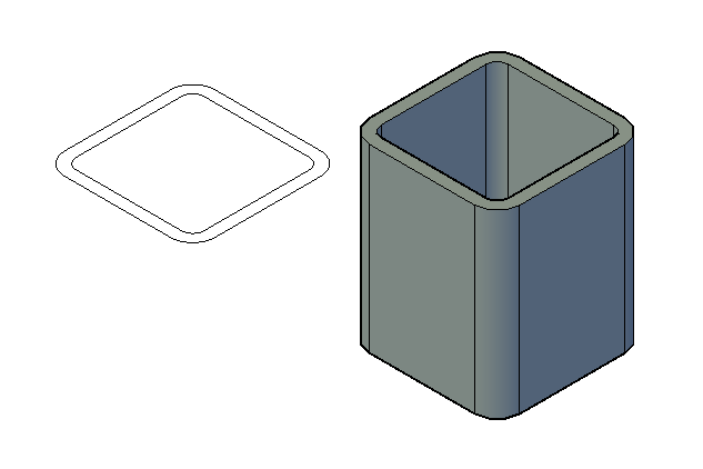

ReMark Posted August 11, 2014 Share Posted August 11, 2014 (edited) An example of a 3D square tube. The profile is to the left. This 6" high 5x5x.375 tube shape was created with the PressPull command. I could have also used the Extrude command. I'd recommend building a library of often used shapes using the Region command to subtract the inner profile from the outer profile then save as a block. Insert, explode then PushPull to the desired height. Edited August 11, 2014 by ReMark Quote Link to comment Share on other sites More sharing options...

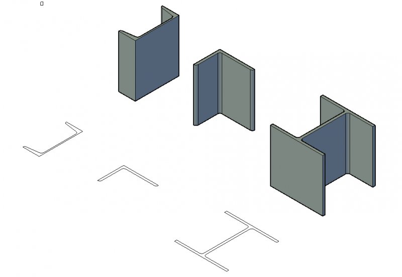

ReMark Posted August 11, 2014 Share Posted August 11, 2014 Examples of other steel shapes in 3D. Each shape is a block. In the image above you'll find a C5x9, L4x3x0.25 and a W6x15. Quote Link to comment Share on other sites More sharing options...

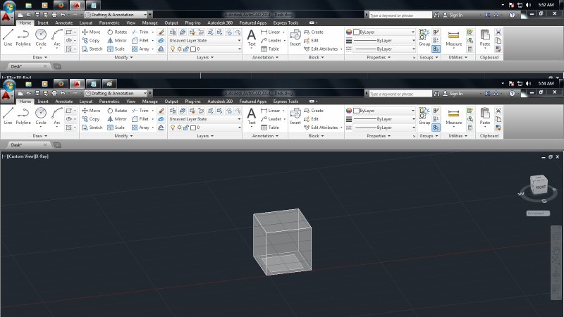

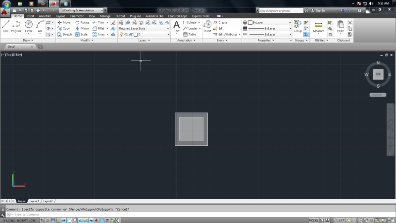

autocad2014newbie Posted August 11, 2014 Author Share Posted August 11, 2014 (edited) Using visual style x-ray, hoping this would be the most helpful to convey what's going on not sure which one you would of preferred. (not sure why the second pic came out doubled). Subtracted: Extruded to [1]: Edited August 11, 2014 by autocad2014newbie accidental doubled screenshot Quote Link to comment Share on other sites More sharing options...

ReMark Posted August 11, 2014 Share Posted August 11, 2014 It appears your use of the Region and Subtract commands failed to produced the required results. No matter. Extrude the inner square then subtract from the outer square to get the final hollow tube. Why do you have Thickness set to 4'-2"? Are you aware that if you subtract the cylinders from the legs of the desk the holes will not pass entirely through the legs? Quote Link to comment Share on other sites More sharing options...

autocad2014newbie Posted August 11, 2014 Author Share Posted August 11, 2014 Hmm, then I am using the subtract command correctly. Question, when drawing a square from top view in autocad, let's say you were to pan the view, does the square you just drew have some height on it? I'm not sure if this is normal, but everytime I draw a square in the beginning, I pan the view and the square is not just a plain square with 0 height, it's about 4ft. long up. I'm thinking this might have something to do with my problem. Is this normal? Quote Link to comment Share on other sites More sharing options...
ReMark Posted August 11, 2014 Share Posted August 11, 2014 That is not normal and the reason you are seeing that is because you have THICKNESS set to 4'-2". Set it to "0". Quote Link to comment Share on other sites More sharing options...
