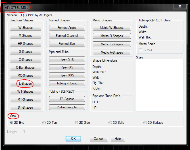

autocad2014newbie Posted August 18, 2014 Author Share Posted August 18, 2014 Can you help me out a bit here with Al's Steel Mill. Did some googling around and says I should link the folder to autocad's support path? Also found from another thread that the original .zip came with a help file, the updated one doesn't. Any idea on what the proper path for this folder should be, how to link it to autocad, and how to bring up the dialogue? Quote Link to comment Share on other sites More sharing options...
BIGAL Posted August 19, 2014 Share Posted August 19, 2014 If you Config, Files, Support file search path this will show you the locations that are currently automatically searched, you can add any path you like, so I have a LISPS directory on the server this is where I would place Al's steel mill this way I can simply load a program by short name not needing full path (load "mylisp") alternatively you can use Appload to load a program. I dont have the Al's steel mill here so can not advise further sure Remark will. Quote Link to comment Share on other sites More sharing options...
ReMark Posted August 19, 2014 Share Posted August 19, 2014 Yes, there really is a help "text" file. It is named STL_HELP.TXT. read it. Yes, the location of the folder containing all 22 files must be included in AutoCAD's search path. This can be done in one of two ways. 1) Move the files to a folder that is already listed or 2) Create a new path to the folder via Options > Files > Support File Search Path > Add button. There is no "link" required to run the program. It can be loaded using the APPLOAD command, using ACADDOC.lsp or via the Startup Suite. For more information on these three methods click on the link below. http://lee-mac.com/tutorials.html You want to read: How to Run An AutoLISP Program and Loading Programs Automatically. Once the program is loaded all you have to do to run it is type STL at the command line. The dialog box. Got all that? Good. Now go do it. Quote Link to comment Share on other sites More sharing options...

ReMark Posted August 19, 2014 Share Posted August 19, 2014 I had no such problems. Can't imagine what you might have done wrong to create such havoc. BTW....I installed it fresh in AutoCAD 2014 this morning. Quote Link to comment Share on other sites More sharing options...
Dadgad Posted August 19, 2014 Share Posted August 19, 2014 I had no such problems. Can't imagine what you might have done wrong to create such havoc. BTW....I installed it fresh in AutoCAD 2014 this morning. I was amazed too, wanted to suggest it for a friend of mine. I wish I had gotten it to work. not so much that I need it, as I like it. Come to think of it, I had tried to install it once before, still had it in my LISP folder, and also failed to get it working, although without any catastrophic inconveniences. The STL command was recognized, but the dialog box never opened. Can't win them all I guess. Quote Link to comment Share on other sites More sharing options...
ReMark Posted August 19, 2014 Share Posted August 19, 2014 Well after I read your post I went back and shut down AutoCAD 2014 then restarted it. I used the APPLOAD method for loading the routine and it worked without a hitch. BTW...I still had access to my custom acad.pgp file as well. What method did you use to load the program? Quote Link to comment Share on other sites More sharing options...
Dadgad Posted August 19, 2014 Share Posted August 19, 2014 (edited) Well after I read your post I went back and shut down AutoCAD 2014 then restarted it. I used the APPLOAD method for loading the routine and it worked without a hitch. BTW...I still had access to my custom acad.pgp file as well. What method did you use to load the program?[/quote I used the Auto Lisp load application selected from the TOOLS dropdown on the menu bar, and watched it load and confirm that it had loaded. As I said earlier, the STL command was recognized, but the dialog never opened. I tried to escape from the lisp, as it obviously wasn't working correctly, but I couldn't abort, so I shut Autocad down. It changes a bunch of the system variable settings temporarily, as described in the help text, and they are supposed to reset after running the lisp, but it seemed like the abort handling was insufficient to restore my settings. When I rebooted Autocad, none of my custom shortcalls were recognized, and so I went to open my ,pgp file, to see what was up, and it was reported as unfound. What a jerk I am. I figured hey, let's try it again, glad I did on Autocad 2012, instead of 2013 which I broke yesterday. Now my Autocad 2012 is displaying the same issues as I reported earlier. I am attaching a couple of screenshots, but don't care to try it again, nor to fix my 2012 at the moment, as I wasted so much time doing it yesterday on 2013. I tried REPAIRING Autocad, but that didn't fix it. Edited August 20, 2014 by Dadgad Quote Link to comment Share on other sites More sharing options...
