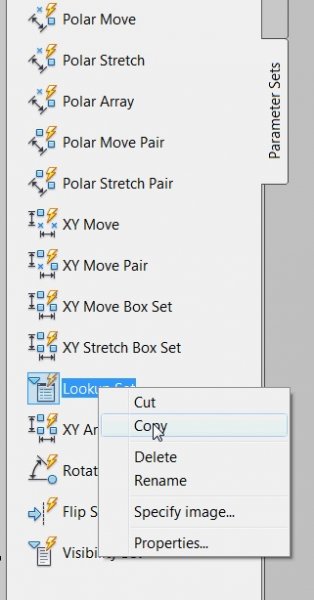

In the block authoring pallette goto the parameter sets tab, right click the lookupset and select copy,

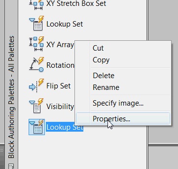

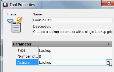

then in the pallette right click and paste, this creates another lookupset, right click on this and select properties,

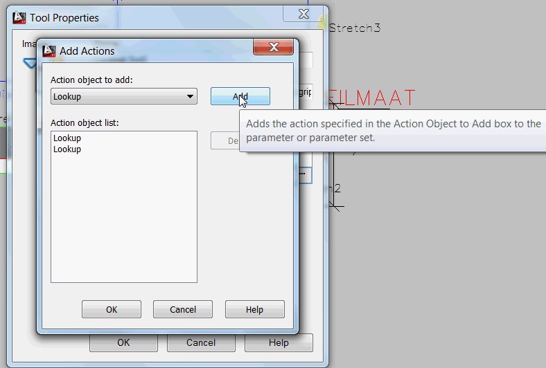

change the name and click in the actions box and then click on the ellipses which will allow you to add a second lookup action to the set.

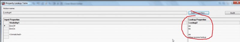

To use the double lookup the lookup properties both have to have the exact same label,
but doing this makes it possible to link 2 actions in a dynamic block, changing the dim / stretch is then linked to the visibility state, I set it up so below .5mm its not visible and above that the dim is visible. It takes longer to explain than to do, take a look at the block and see how it works.
