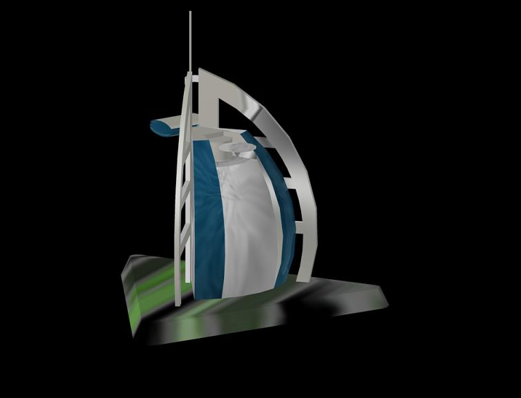

Hassy Posted November 12, 2014 Author Share Posted November 12, 2014 This is what currently my Burj looks like Quote Link to comment Share on other sites More sharing options...
Hassy Posted November 12, 2014 Author Share Posted November 12, 2014 Yeah I know about the viewports, but what it has to do with printing?? I don't know about layouts.. Quote Link to comment Share on other sites More sharing options...
ReMark Posted November 12, 2014 Share Posted November 12, 2014 Many users find it easier to print their 3D model from a layout using a viewport than from model space. Layouts are printed at a 1:1 scale. The only thing that gets a scale assigned to it is the viewport (not the objects that can be seen in it) itself. Quote Link to comment Share on other sites More sharing options...
