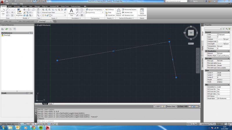

Can you post a screenshot of the palette?

See screenshot - I have drawn and highlighted a Polyline and the options in the palette (to the right) dont give me the normal options to affect Global Width or give me info about the element (length etc). Very odd.
