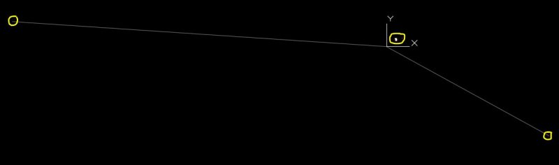

Guitte Posted December 3, 2014 Posted December 3, 2014 Im getting some difficulties with "blocks". I copied and paste a M8 Nut block from a standard drawing sheet into the current drawing. In the design center of the current drawing it shows i have a M8 Nut block. I tried to drag it out of the design center into the drawing, nothing. I have used purge & overkill on both drawings and tried it again, no luck. Checked both drawings if layers exist, it does. Check if any layers are switch off, everything is on and still nothing. What am i doing wrong? Any assistance will be highly appreciated. Quote

ReMark Posted December 3, 2014 Posted December 3, 2014 I invoked BEDIT and picked the M8 Nut Side block from the list of blocks in the drawing. When the block editor opened there was nothing to be seen. Apparently the objects were erased. That's why AutoCAD could find where each "block" was inserted using QSELECT but you could not see the block because there was nothing to see. You might want to fix that. Quote
Guitte Posted December 3, 2014 Author Posted December 3, 2014 That is the problem, how do i fix something that i cant see? Don't understand. I copied and paste, and nothing to see, then to prevent overlapping i did undo. How come the design center see the block, but not the drawing. Quote
ReMark Posted December 3, 2014 Posted December 3, 2014 Erase all instances of the block you can't see using QSELECT. Purge the now unreferenced block definition. Save the drawing. Reinsert the block. Quote
ReMark Posted December 3, 2014 Posted December 3, 2014 Here are the eight blocks you inserted that cannot be seen. Two are literally way off in space on either side of the main group of geometry. I've drawn a line from the insertion point of each back to 0,0. I put one big circle around the remaining six blocks that are grouped in the center of your geometry. How did I "see" your blocks? I used BEDIT as previously mentioned and drew a circle with a radius of 100 with its center located at 0,0 then changed the color to red. I saved this edited block prior to closing BEDIT. Using QSELECT it was easy to find the two "lost in space" blocks and the other six were even easier to spot. That's how one can see the unseeable. Understand? Quote
