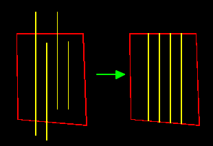

subodh_gis Posted December 8, 2014 Share Posted December 8, 2014 Can we extend inside polylines and Trim outside polylines to selected polyline boundary. See the attached Image Quote Link to comment Share on other sites More sharing options...
Tharwat Posted December 8, 2014 Share Posted December 8, 2014 Use either the Extend or trim command with Shift button down to step through these two commands in one go . Quote Link to comment Share on other sites More sharing options...

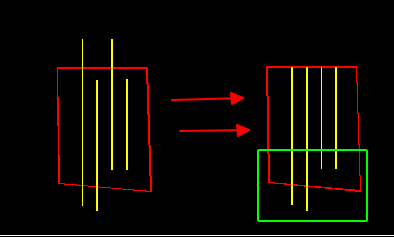

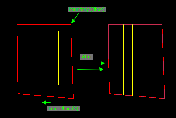

danghungxda300449 Posted October 25, 2023 Share Posted October 25, 2023 (edited) 15 hours ago, Steven P said: What are your skills with lisp, that will determine what help we need to give you - might be you just need to know the relevant commands, might be that you know nothing of LISPs and want the finished thing... or anything in between. Will your LISP just be extending or trimming to a closed object (like the square above) or will it be to any object? "I have a set S consisting of lines (or polylines) located within a bounding area (for example, Bbox), where S may have lines that intersect at one end or both ends, and it may also not intersect with the Bbox boundary. Now, I want a Lisp routine to select the bounding area (or possibly select additional lines from set S) to trim all the excess ends, and simultaneously extend the short ends of lines in set S that do not intersect with the Bbox boundary, as illustrated in the diagram. I have found a Lisp routine that can trim the excess ends of lines intersecting with the Bbox boundary, but it cannot extend the lines that do not intersect with the Bbox. Can you or someone else help me! Thanks You. Edited October 25, 2023 by danghungxda300449 Quote Link to comment Share on other sites More sharing options...

danghungxda300449 Posted October 26, 2023 Share Posted October 26, 2023 38 minutes ago, exceed said: https://www.theswamp.org/index.php?topic=3517.msg391379#msg391379 you can start with this Thank you for sharing. I have also seen the Lisp code you provided on a forum. However, this Lisp code only allows selecting a cutting edge as an open line or polyline and only trims and extends lines at one end. I want the cutting edge to be a closed bounding area (e.g., a rectangle) and the lines to be simultaneously cut/extended at both ends (See the illustration for more details). Quote Link to comment Share on other sites More sharing options...

BIGAL Posted October 26, 2023 Share Posted October 26, 2023 Intersectwith is the way to go but need to be careful with plines with multiple vertices as reset start and end points. If the pline is like a line only 2 points then easy just get the 2 intersection points, note that intersectwith will return the 2 points as a list. (setq obj1 (vlax-ename->vla-object (car (entsel "\nPick object boundary ")))) (setq obj2 (vlax-ename->vla-object (car (entsel "\nPick object ")))) (setq intpt1 (vlax-invoke obj2 'intersectWith obj1 acExtendThisEntity)) ; (431.980513473978 104.0 0.0 309.151716524031 -142.0 0.0) ; for a line can use this (vlax-put obj2 'startpoint (list (car intpt1)(cadr intpt1)(cadr intpt1))) ; for a pline use (vlax-put Obj 'coordinate 0 (list (nth 3 intpt1)(nth 4 intpt1)(nth 5 intpt1))) (vlax-put Obj 'coordinate 1 (list (nth 0 intpt1)(nth 1 intpt1)(nth 2 intpt1))) This should be enough help to put soething together have to go now. 1 Quote Link to comment Share on other sites More sharing options...

Danielm103 Posted October 27, 2023 Share Posted October 27, 2023 You don’t need to explode the boundary , you need to extend both ends with vla-IntersectWith, I’m not familiar with LM:intersections 1 Quote Link to comment Share on other sites More sharing options...
danghungxda300449 Posted October 27, 2023 Share Posted October 27, 2023 18 minutes ago, Danielm103 said: You don’t need to explode the boundary , you need to extend both ends with vla-IntersectWith, I’m not familiar with LM:intersections So, is it possible to simultaneously trim and extend both ends?" Quote Link to comment Share on other sites More sharing options...
Danielm103 Posted October 27, 2023 Share Posted October 27, 2023 (edited) Yes, in the example BIGAL posted intersectWith returns the intersection on both sides Edited October 27, 2023 by Danielm103 1 Quote Link to comment Share on other sites More sharing options...
